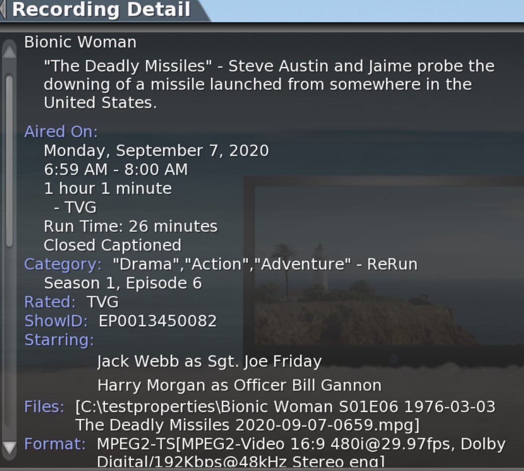

It works I did a test filled out what I could from the JSON .... didn't have the Actors so used what I had lol.
{"Description":"Steve Austin and Jaime probe the downing of a missile launched from somewhere in the United States.","Episode":6,"Genres":["Drama","Action","Adventure"],"IsMovie":false,"IsSports":false,"MetadataGenerator":"Channels DVR","OriginalBroadcastDateTime":"1976-03-03T00:00:00Z","RecordedDateTime":"2020-09-07T14:00:00Z","Season":1,"SeriesPremiereDate":"1976-01-14T00:00:00Z","SubTitle":"The Deadly Missiles","Title":"Bionic Woman"}
Bionic Woman S01E06 1976-03-03 The Deadly Missiles 2020-09-07-0659.mpg.properties
#Generator: CMT Metadata, written on Wednesday, September 16, 2020 2:42 PM
Subtitled=false
Genre="Drama","Action","Adventure"
Contestant=
ChannelPremiere=false
RunningTime=1560000
Widescreen=false
Guest=
Choreographer=
ExtendedRatings=
Dolby=false
Composer=
Writer=
Stereo=false
ParentalRating=TVG
EpisodeNumber=6
PropertiesWrittenBy=CMT
Description=Steve Austin and Jaime probe the downing of a missile launched from somewhere in the United States.
ExternalID=EP0013450082
SAP=false
HDTV=false
Title=Bionic Woman
SeasonNumber=1
AltEpisodeNumber=
CC=true
SeriesFinale=false
Live=false
Voice=
Surround=false
Judge=
EpisodeName=The Deadly Missiles
Director=
SeriesPremiere=false
Anchor=
Guest\ Voice=
3D=false
DD5.1=false
Executive\ Producer=
Guest\ Star=
SeasonPremiere=false
AiringTime=
Musical\ Guest=
New=false
Letterbox=false
Taped=false
Producer=
Misc=
Language=
Dubbed=false
Narrator=
SeasonFinale=false
Rated=
Correspondent=
OriginalAirDate=-1976-03-03T00:00:00Z
Host=
Team=
Year=
Premiere=false
AiringDuration=
Actor=
I believe SageTV looks for the original airdate in EPOCH.
