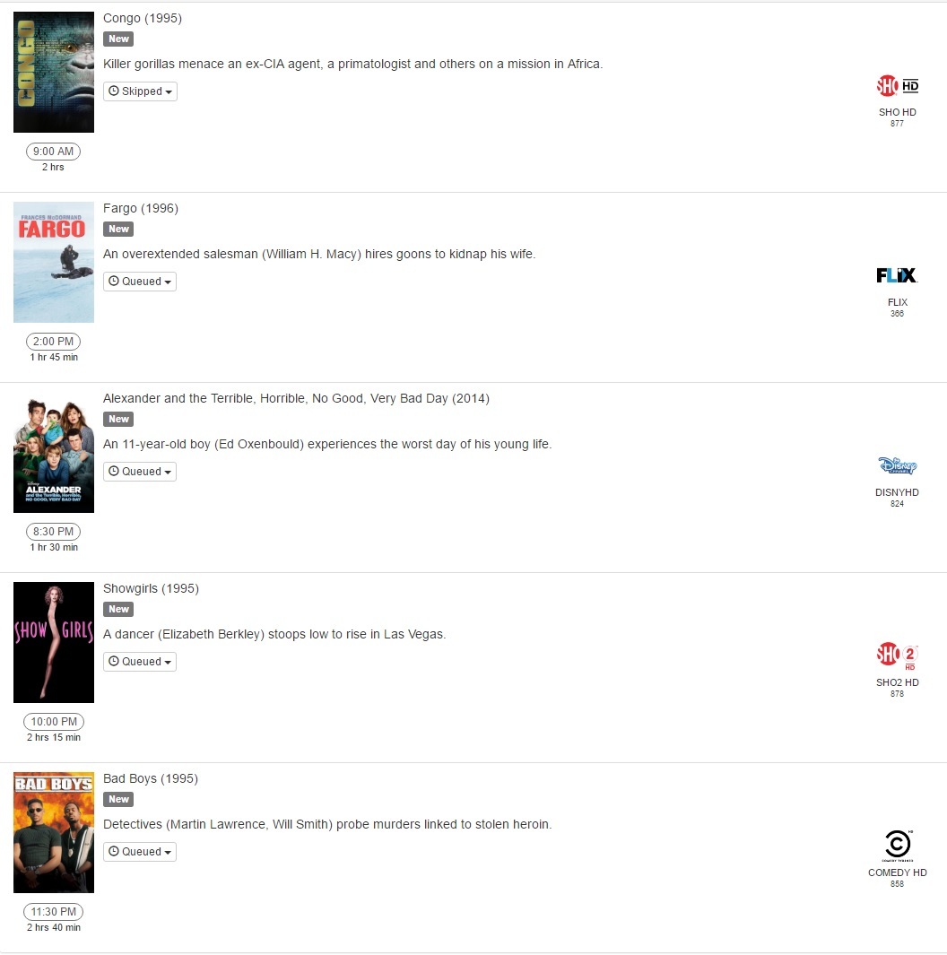

I have a bunch of movies set to record that i did not schedule to record. I'm the only one in the house using Channels DVR so it is a mystery to me as to how the movies got scheduled. I have set them all to skip for now and will keep an eye out to see if anything new shows up.
Attached screenshot.

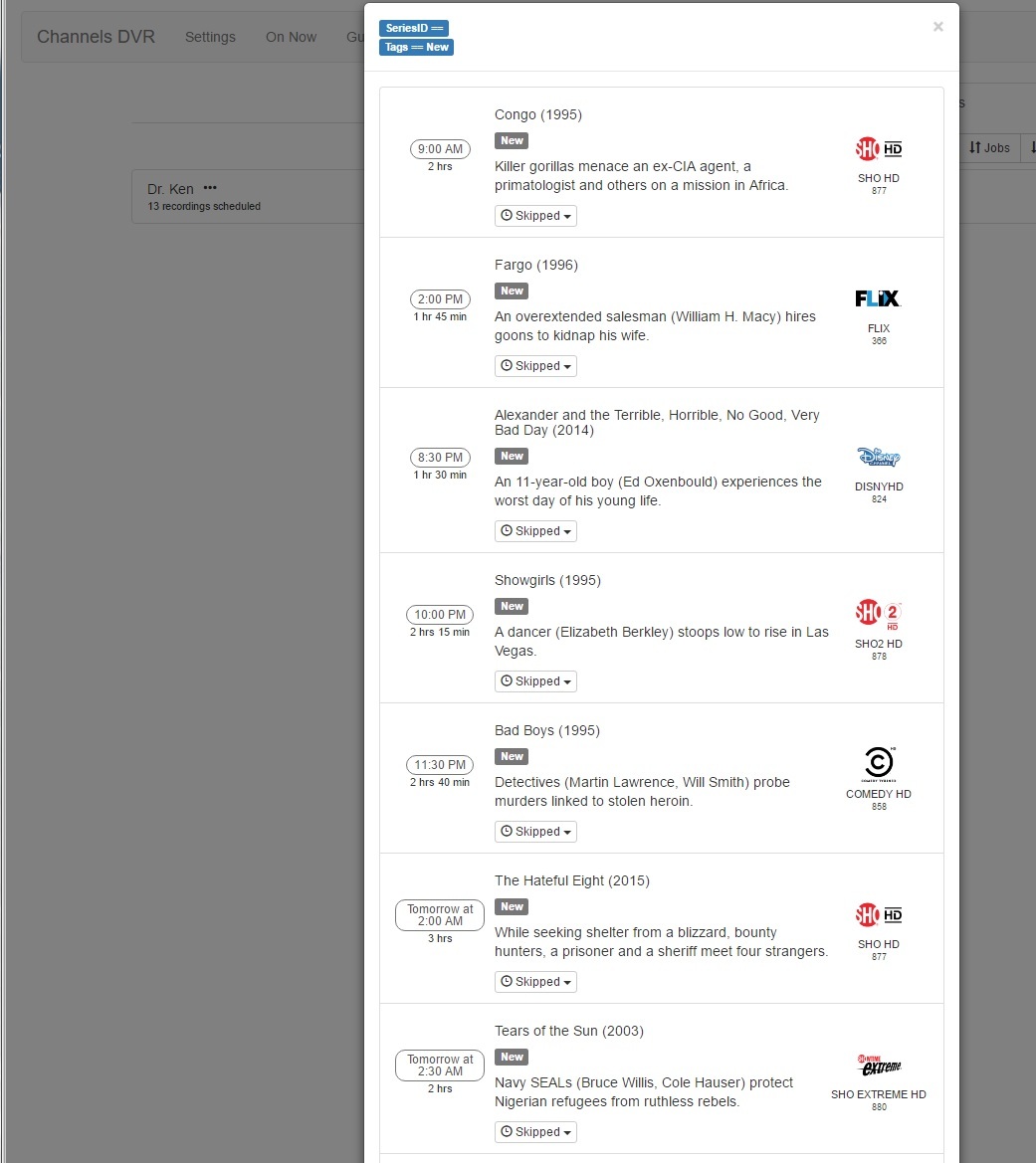

Yeah, if the movies have the option to “skip” and not “cancel” it means they were set up with a pass. This is definitely weird.
How did you set up this pass? Did you do a search, find Dr. Ken, and create a pass for it? Could you do the search again and look at the upcoming airings it shows for it?
Whoa, I just noticed that your rule says “SeriesID =”, which means it’s nil. So that’s why it’s scheduling all of those movies. They’re the only things that have no SeriesID.
How did you go about making this rule?
I searched for Dr. Ken and created a pass for it. I was able to recreate the issue earlier by deleting and recreating the season pass. This time however when i deleted and recreated the pass it worked properly. I will keep an eye on this and let you know if i see any other oddities.
