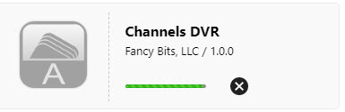

Follow-Up: Tried to remove Channels DVR App using App Manager - The Channels DVR Icon went away but got an error saying NAS couldn't remove the App. Tried to Reinstall the App manually using the App Manager - Got an error saying NAS couldn't reinstall Channels DVR.
Channels DVR Install Hangs Up
Is there a way to manually remove and reinstall the Channels DVR Server since the NAS App Manager can't do it? I'd hate to lose two years of the logs, database and images. Help ..
