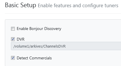

P.S. Just figured out if you don't enable Commercial Detection in your Channels DVR settings, you can't re-comskip anything.
