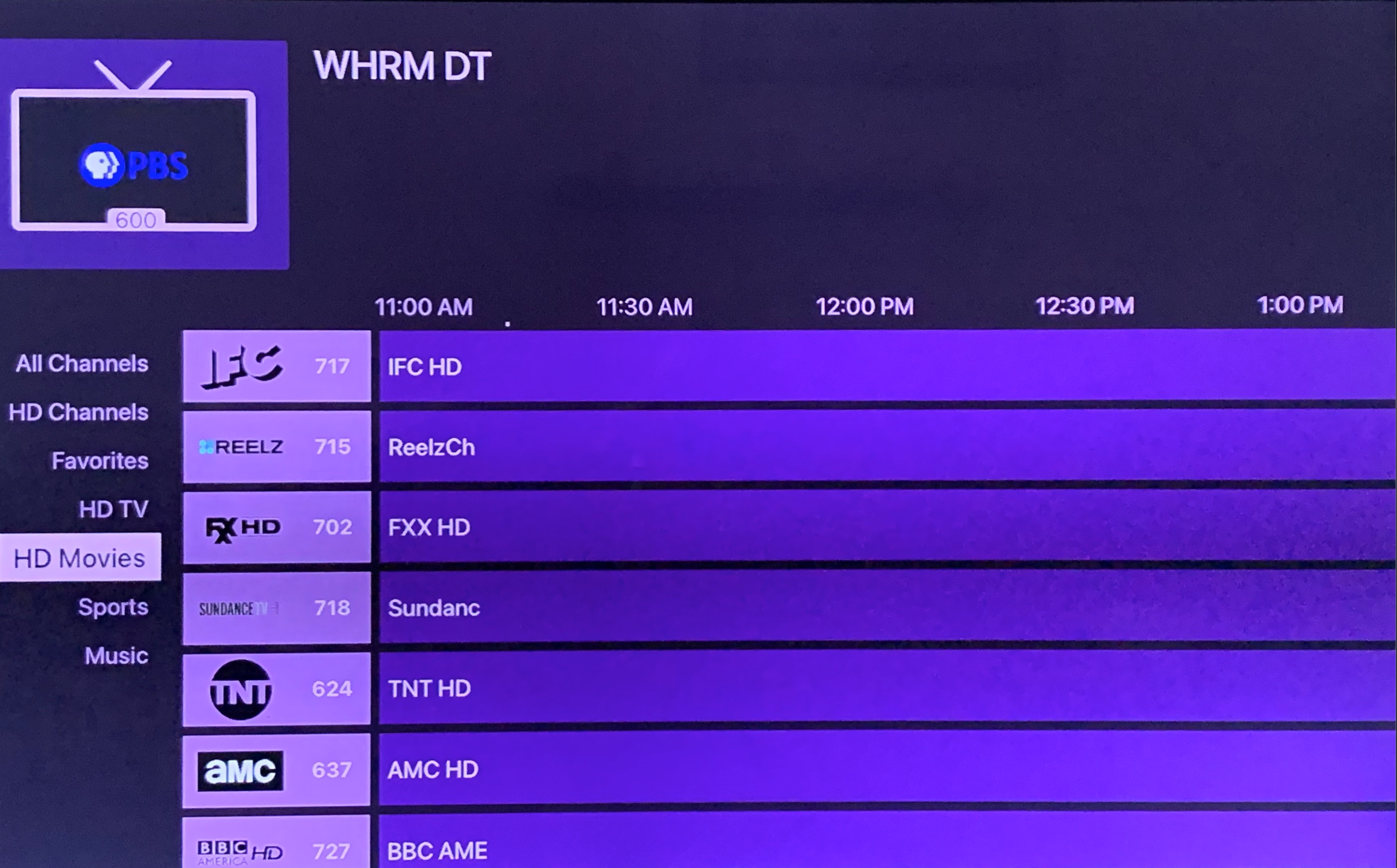

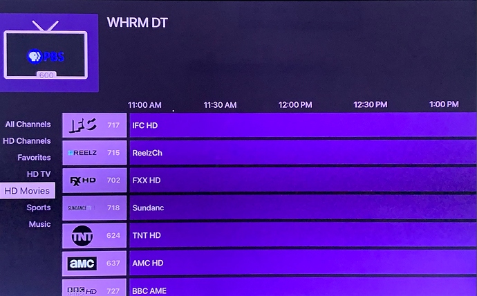

One of my AppleTVs (tvOS) shows the Enhanced Library channel collections but the guide data never populates in them. Any thoughts for something to try to make them show guide info? it works on my phone (iOS) fine. If I navigate to Favorites or HD channels, those are populated as well on the AppleTV.

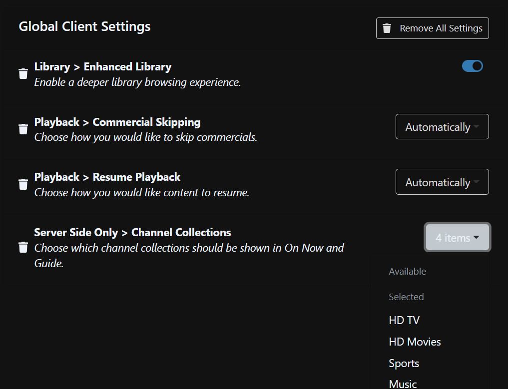

Clearly there's something set up wrong with your device. Please submit diagnostics from your DVR.
Also, please check your Client Settings section to see if you have things configured specifically for that device:
https://getchannels.com/docs/channels-dvr-server/how-to/server-side-settings/
The settings are globally configured - and all three clients (iPhone, two AppleTVs) are listed. The diagnostics were just submitted.

- The Guide of the collections appear but has no data in it.
