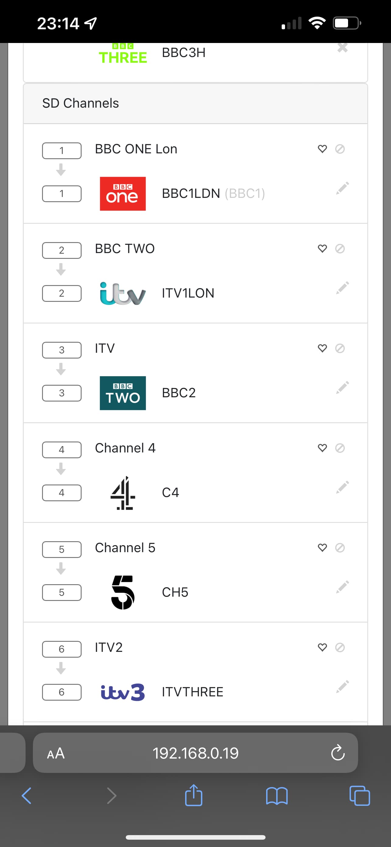

WTH is going on with the EPG? It’s all messed up and it doesn’t seem to matter if I rescan, redownload, re-sync etc it just stays like it.
You can click the pencils in the first photo and fix the mappings
Thanks - handy to know but I guess my question is more why is this happening, as if it’s not just the one or two channels I can easily identify then it could be dozens and I don’t want to be doing that manually. HDHomeRun has the listings showing correctly so I’m curious at what stage the channels are being flipped.

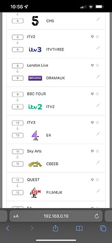

Actually I just looked a little more and loads of the channels are messed up. Never had this problem before :sob: Probably of no relevance but I always ran the server on a Shield, now it’s on a Synology DS1520.
Yep pretty much every channel is wrong apart from the HD channels
Try clicking the gear icon next to HDHR, hold down the SHIFT key on keyboard and click Sync Mapping
Hasn’t helped unfortunately, it couldn’t be more messed up if it tried at the moment, guide completely disagrees with the channel and what is actually on TV, channels appearing that I’ve never seen before (all in German and I’m in the U.K.!). I’ve deleted the source, re-triggered and re-built everything there is and it’s still a mess :frowning:
Also the guide in the web app is showing completely different programs in the EPG to my iPhone guide. Apparently ITV4 is now (at 7pm) showing Achtung Sexy TV :face_with_raised_eyebrow:
