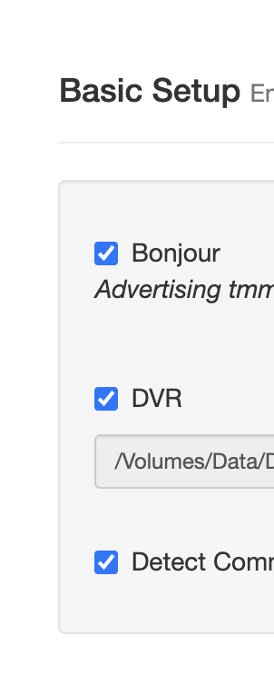

If you could install another instance on your QNAP, and then after setup uncheck the Bonjour checkbox. That way it can just be a test DVR and your TVs will still connect to the mac.

Where do I uncheck the Bonjour checkbox?
Since it never completes the setup of Guide Data, I never get to the screen that has the Basic Setup section. It still has the 3 initial setup steps at the bottom. I'll just uninstall it for now. Interesting that I have the HDHR now, and that is stuck at 1% loading guide data. The TVE still fails as it did before.
Well scratch that... I exited it trying to load guide data, and the finished the initial setup and I could then uncheck Bonjour.
