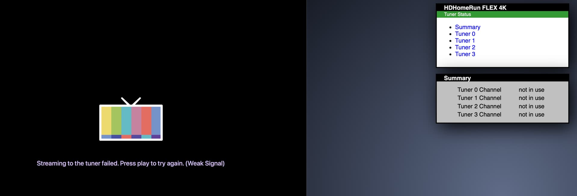

Often, when i select an ATSC 3.0 channel, I get an error message after a delay:
Streaming to the tuner failed. Press play to try again. (Weak Signal)
Pressing play will then start the playback.
Only on ATSC 3.0, mostly on a local OTA FOX channel
Source is HDHomeRun Flex 4k
Your antenna signal is weak
Strange. When I first try it and get the error, the HDHomerun Status page shows No Tuner in use. When I retry it the HDHomerun Status page shows all metrics at 100%
The error we are reporting is the error the HDHomeRun returned to us.
