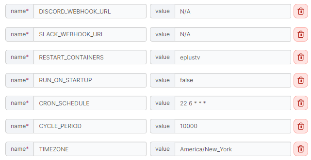

Just a heads up to anyone experiencing this or something similar:
My linear stations seem to break one-by-one over several days until I restart the container. While you can write your own cron job to restart the container, I did find a simple lightweight container in and of itself to just run a daily reset:
The Stack would look like this:
services:
  restart-notifier:
    image: index.docker.io/deduard/tools:restart-notifier-latest
    container_name: restart-notifier
    volumes:
      - /var/run/docker.sock:/var/run/docker.sock
    environment:
#      - DISCORD_WEBHOOK_URL=${DISCORD_WEBHOOK_URL}    # i.e., https://discord.com/api/webhooks/119207436456853270/mRC3HfPoT5_MFsvn3sHUuG1Qeeg3WTUAo_bf0LR8
#      - SLACK_WEBHOOK_URL=${SLACK_WEBHOOK_URL}        # i.e., https://hooks.slack.com/services/T04JS2CSY4U/B06HRRFSRGW/1UL9bv1i1JnaYsUBo
      - RESTART_CONTAINERS=${RESTART_CONTAINERS}       # i.e., nervous_moore1,nervous_moore2
      - RUN_ON_STARTUP=${RUN_ON_STARTUP}               # i.e., false
      - CRON_SCHEDULE=${CRON_SCHEDULE}                 # i.e., 0 4 * * FRI     # INFO: This would be every Friday at 4:00 AM, based on the selected 'TIMEZONE' below
      - CYCLE_PERIOD=${CYCLE_PERIOD}                   # i.e., 10000           # INFO: This would be 10 seconds
      - TZ=${TIMEZONE:-UTC}                            # i.e., America/New_York
    restart: unless-stopped
Note that Timezone is currently commented out. It does not appear to be working for all users (me included), so you have to use UTC. EDIT: Timezone is now working as of v2.3.4! Otherwise, this is an example of the environment variables:
So this would restart the EPlusTV container at 06:22 UTC, which is 2:22 AM EST 6:22 AM EST.
