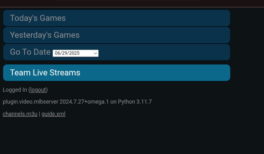

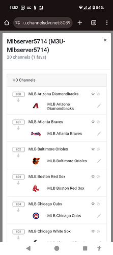

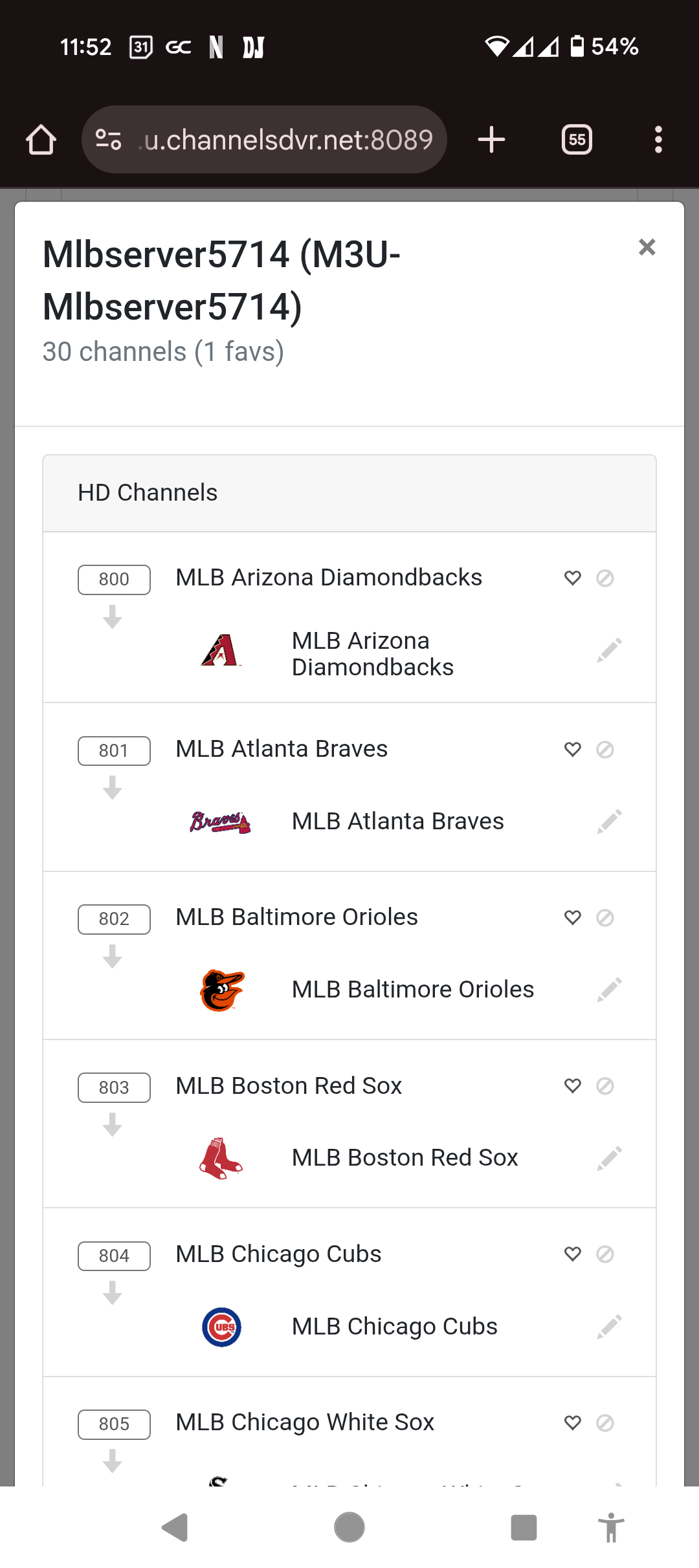

I don't see where, could you send a screenshot of where I should look? I only see these
And only 30 streams appear, one for each team in Channels
Ah, you’re on the experimental Python version which isn’t being updated anymore.
Get the main NodeJS version at GitHub - tonywagner/mlbserver
Sorry for the confusion!
