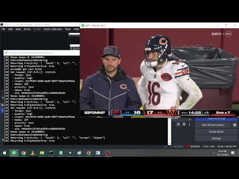

I even ran ffmpeg
ffmpeg -i http://localhost:8000/channels/3007.m3u8 -t 60 -c copy test.ts
That worked fine. I included logs here, one of the main coder there doesn't know what to do either. He says its eplustv fault, but it works fine on ffmpeg and vlc. Any ideas?
https://forums.nextpvr.com/showthread.php?tid=66598&pid=604109#pid604109
This is how it loads in nextpvr, only ESPN3 does it. - I don't think SEC+, ACCX or Linear do this
