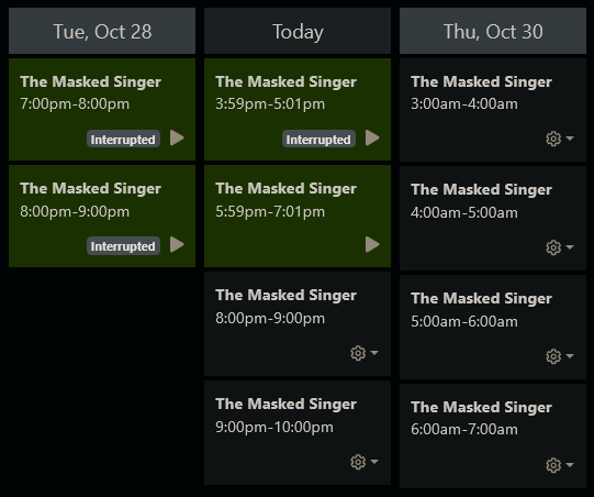

I was beta testing for a couple days and thought everything was working fine. But I was only briefly tuning each new Fox One linear channel to test.
Now that I've made a few recordings, I'm not sure where the problem is, but Channels DVR is showing interrupted recordings.
I've only recorded 3 episodes from the Fox One channel The Masked Singer and all three were interrupted recordings.
This is the error from the latest one (192.168.1.4:8185 is the EPlusTV container)
2025/10/29 16:00:56.644326 [DVR] Error running job 1761778770-ch51 The Masked Singer: Could not fetch playlist from 192.168.1.4:8185: GET: http://192.168.1.4:8185/chunklist/219/JirKeHE6.m3u8: 404 Not Found
I do see a corresponding error in the container log, but it take up 182 lines of the log.
Starts with
2025-10-29T23:00:52.322630051Z AxiosError: read ECONNRESET

Appears the connection was RESET by Fox One?
Obviously I picked something just to test recording. Don't care about the episodes (they're also airing the same schedule on Tubi).
From what i can see, the feed wil keep going for a bit then it will die.
Don't know if any of this will make a difference.
My recordings today using v4.14.0 had been padded pre-30 seconds, post-1 minute.
Channels DVR just released another (2nd) stable release.
I just updated the EPlusTV container to 4.14.1.
I scheduled more recordings (2 tonight, 4 tomorrow) on the same linear channel with no padding.
Screenshot 2025-10-29 at 19-54-35 Channels Calendar
One of the advantage of using 7 servers is room to test :wink:
I saw this while beta testing, too, and noted it, but didn't notice any hiccups in the recordings themselves (granted, I fast forwarded a bunch, so might have missed something). Channels DVR often gives me the interrupted tag for custom stations, so I just write it off with a :man_shrugging:t3:. It might account for one imperceptible frame lost, but technically it's a drop!

what does it say in the channels dvr log? Is there something in there about a .key file?
2025/10/30 14:15:12.937776 [SNR] Rewriter statistics for 192.168.1.148 (6810 Office) for ch16004 EPlusTV 5: discontinuity_detected=0 transport_errors=0 saw_pcr=true saw_pmt=true highest_pts=716.699322
2025/10/30 14:15:12.938313 [SNR] Buffer statistics for 192.168.1.148 (6810 Office) for ch16004 EPlusTV 5: buf=0% drop=0%
2025/10/30 14:15:12.939013 [SNR] Streaming statistics for 192.168.1.148 (6810 Office) for ch16004 EPlusTV 5: timeouts=1 segment_timeouts=0 playlist_timeouts=1
2025/10/30 14:15:12.952862 [TNR] Closed connection to M3U-ESPPLUS for ch16004 EPlusTV 5
2025/10/30 14:15:12.952862 [TNR] Error during live stream for ch16004 EPlusTV 5: failed after 31.160673s: hls: temporary failure while downloading: Get "http://192.168.1.180:8000/channels/5/5-segment-Y12xviVW.ts": hls: timeout while waiting for data
2025/10/30 14:15:21.512298 [M3U] stream timestamps: EPlusTV 5: start_at=2025-10-30T14:00:17-05:00 end_at=2025-10-30T14:15:16-05:00 live_delay=3.169298201s
2025/10/30 14:15:21.512298 [TNR] Opened connection to M3U-ESPPLUS for ch16004 EPlusTV 5
2025/10/30 14:15:52.022786 [SNR] Rewriter statistics for 192.168.1.148 (6810 Office) for ch16004 EPlusTV 5: discontinuity_detected=0 transport_errors=0 saw_pcr=true saw_pmt=true highest_pts=30.013322
2025/10/30 14:15:52.023339 [SNR] Buffer statistics for 192.168.1.148 (6810 Office) for ch16004 EPlusTV 5: buf=0% drop=0%
2025/10/30 14:15:52.023339 [SNR] Streaming statistics for 192.168.1.148 (6810 Office) for ch16004 EPlusTV 5: timeouts=0 segment_timeouts=0 playlist_timeouts=0
2025/10/30 14:15:52.026635 [TNR] Closed connection to M3U-ESPPLUS for ch16004 EPlusTV 5
2025/10/30 14:15:52.026635 [TNR] Error during live stream for ch16004 EPlusTV 5: Could not fetch playlist from 192.168.1.180:8000: GET: http://192.168.1.180:8000/chunklist/5/v6Fhn1vM.m3u8: 404 Not Found
2025/10/30 14:16:05.178667 [M3U] stream timestamps: EPlusTV 5: start_at=2025-10-30T14:01:01-05:00 end_at=2025-10-30T14:16:00-05:00 live_delay=2.791667301s
I did a search for "key" and got this up a bit:
2025/10/30 13:20:54.400533 [TNR] Error during live stream for ch16004 EPlusTV 5: Failed to download segment 8283200: http://192.168.1.180:8000/channels/5/5-segment-LCGmrpSR.ts: GET: http://192.168.1.180:8000/channels/5/5-key-qPs1LzoH.key: 404 Not Found: "404 not found"
2025/10/30 13:21:28.913109 [M3U] stream timestamps: EPlusTV 5: start_at=2025-10-30T13:06:24-05:00 end_at=2025-10-30T13:21:23-05:00 live_delay=3.800109201s
