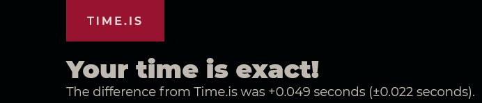

Is your time zone and time correct on your device running the container?
There is a token expiration time of Thursday, November 6, 2025 18:38:10 UTC embedded in the URL's (&hdnts=exp%3D1762454290)
Have you tried overriding the container DNS server?
The date/time is correct on the Windows server that Docker Desktop is running on.
I don't know how to set the time zone/time in Docker Desktop / the container. Can you tell me how? Will this cause random playback hiccups if set to default?

Are the times shown in the log accurate for your time zone?
It's 12:20 here in CA (UTC -0800)
You can check using a browser on your server and go to https://time.is/
2025-11-06 14:09:26.088
I think so. It was 2:09 CST here??
How accurate does it say your clock is?
