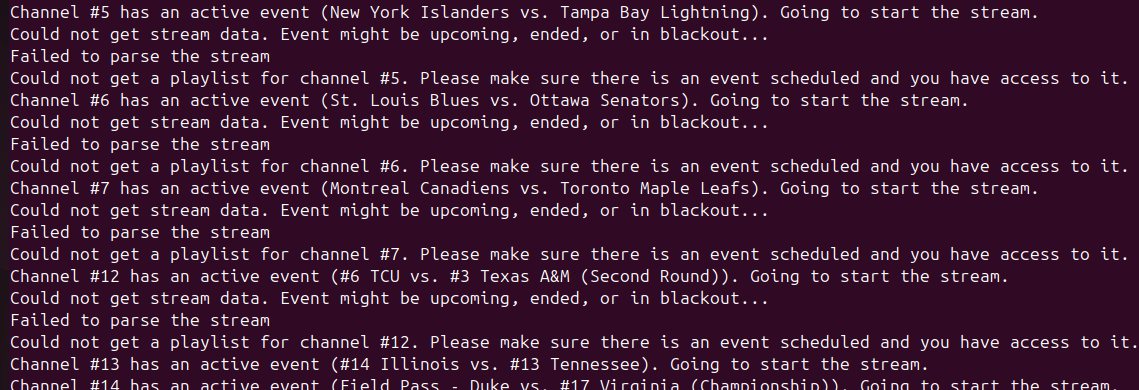

Gotham Sports (MSG) stopped working tonight.
Log says: Could not get a playlist for channel #160. Please make sure there is an event scheduled and you have access to it.
And http://192.168.1.8000/channels/160.m3u8 is getting a 404 error.
Other channels seem to be working, even other Gotham Sports channels.
Any ideas?
Restart the EPlusTV container and try again — that was reported to work for this Gotham error upthread.

I'm having an issue with pretty much all the channels I watch on EplusTV. A channel will play fine for a while, and then I get the message, "The connection to the tuner was lost. Please try again." I go back into the channel, and the same thing happens again after a little while. What logs would you need to see to diagnose the problem?
I wonder if you are having the same issue as me?
Could be, but I did not have proxy segment files checked.
Neither do I. What device(s) are you using for Channels clients?
I use 4k AppleTVs
Ok I would post your container logs for @tonywagner to look at.
