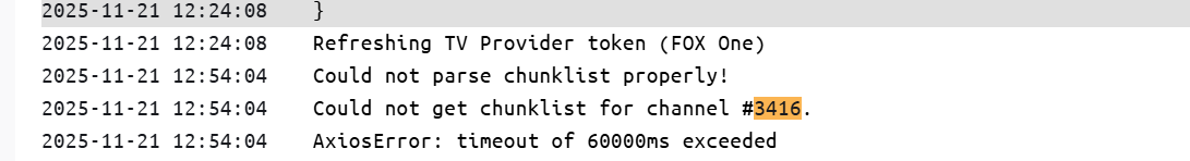

Getting issues with the chunklist. Can we fix it
I see others asked about it too. The consistent m3u8 from foxone works fine, it doesnt need to refresh token so often it just needs the right m3u8, fa.edge versus cf.edge

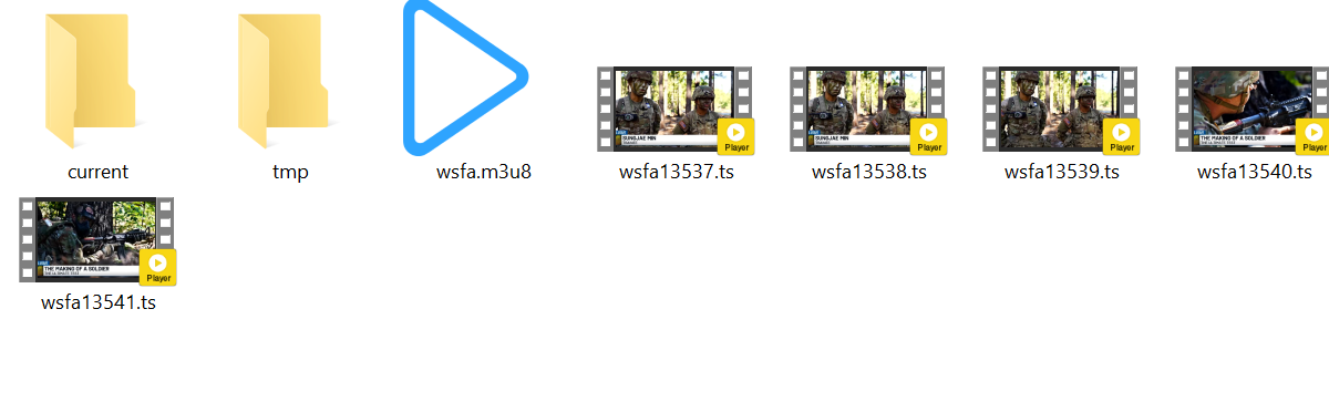

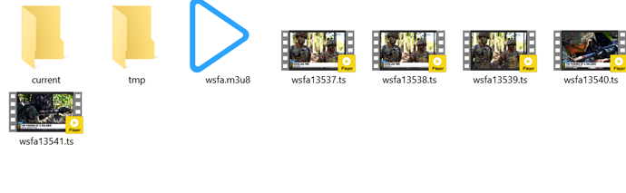

Can yall take a look at this python code? You need selenium, chrome driver and change folders.
It works decent and serves the m3u8 here:
http://localhost:8000/wsfa.m3u8
Can we make it better using hlsproxy? It does the baton handoff and everything, but it has to constantly pull files in
pip install selenium
