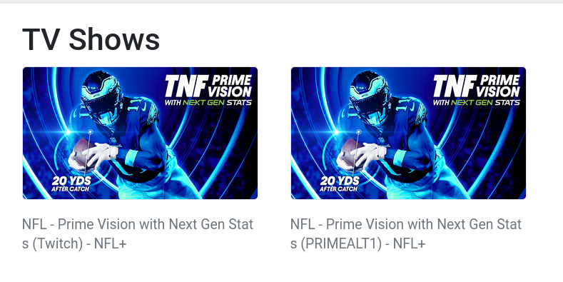

I also added the Twitch TV stream for TNF as an option if you don't have Prime or want a backup
I'm going to be out and about tomorrow. Someone test the Twitch stream and let me know how it goes

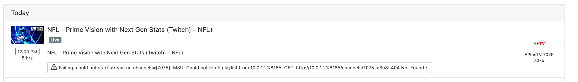

How do you get the Twitch streams to appear?
I enabled it in the web interface, rebuilt the EPG, and even restarted the container, but I still only see the two Prime events in the XML feed.
Looks like no one replied to you — there is now a web interface to configure this, so no environment variables are required.
If you can just install and run the container, just load http://your.ip.address:8000 in a web browser. From there, you can toggle your providers and log in as necessary.
Ahh, I might have forgotten the run the schedule. But after restarting the container they popped up on my server
edit:
Just pushed an update to search for the schedule. Shows up for me
Working here too... I've set up a noon recording :+1:t3:
After updating, I see it now too -- thanks!
Hey, just a heads up: when I initially turned on the Twitch setting, the backend seemed to get stuck. When I reset the Container, everything went fine:

Just tried watching on my phone but it failed to load. When I loaded up the page in the DuckDuckGo browser in my phone it asked if it could use DRM, so I wonder if I'll have to rip it out. Let me know if it works for anyone
Looks like they do use DRM for the Twitch streams: plugins.Twitch: no_cdm_specified for Prime Video TNF Twitch channel · Issue #5592 · streamlink/streamlink · GitHub
