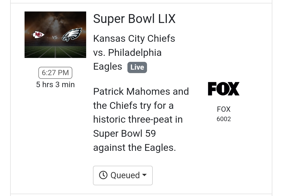

Is anyone's Fox config showing the Super Bowl in 4K coming up? I only have the postgame show in my guide.
Not a huge deal since I have OTA options or could just watch on Fox Sports app (or tubi I think), just want to make sure it isn't my config though

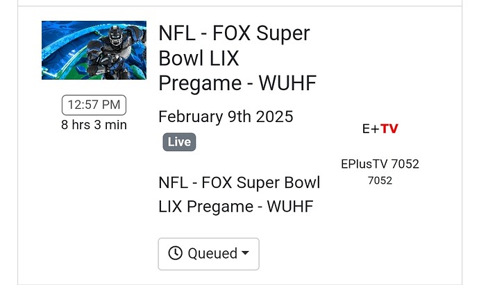

This is what I have in my schedule:
I have no clue if it will be in 4K.

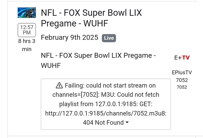

Edit: well, I will never know because:
:cry:
I can't complain because I'm one of the few rare people who still get Fox TVE (I don't have OTA at this time):
