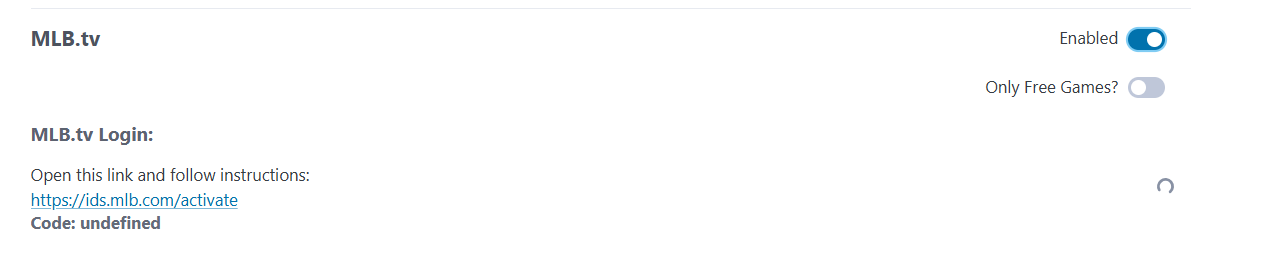

Why do I get this error?
Have you tried this again? I just tried and it's working for me. Maybe a hiccup on the MLB side?

I've already updated, and I'm still getting the same error. What could it be?
Could be a few things... Do other providers work? Is there anything in the logs? Are you on a VPN?
