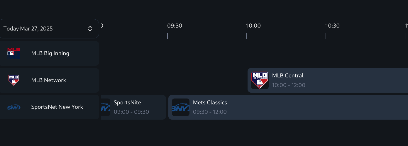

And then inside of the E+ web UI, can you open the /linear-xmltv.xml endpoint in a new tab so that you can view it in this? Curious if it shows anything scheduled on SNY.
This is what it looks like on mine

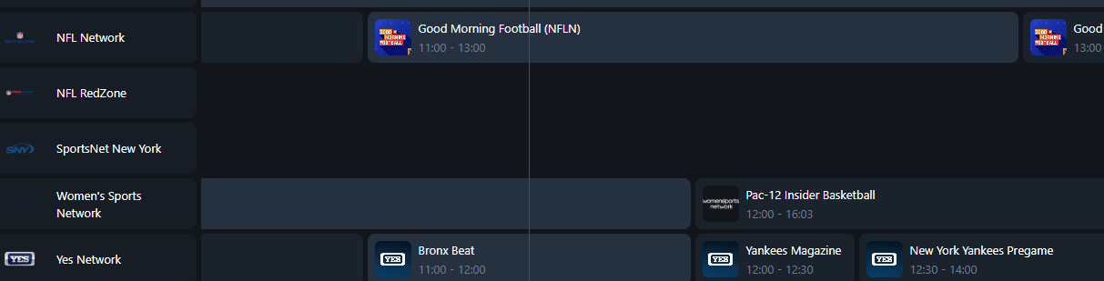

Happy to help troubleshoot, I installed the addon in Chrome and the guide data populates in both the EPG Viewer and within the Channels Guide. But once I click on the current on-air program "Mets Classics" it just doesn't play.
