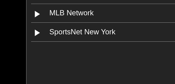

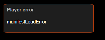

Okay, one more thing to try:
We're going to try bypassing Channels for playback and just try the feed straight from E+:
Install this extension: https://chromewebstore.google.com/detail/native-mpeg-dash-+-hls-pl/cjfbmleiaobegagekpmlhmaadepdeedn
And then open the /linear-channels.m3u link from the UI and hit play next to SNY
I've heard the MLB.tv site has had issues all day. IDK if that maybe the issue here.
nope

I think we're getting closer on yours. I pushed up a fix that'll hopefully do the trick
Cleaner error on newest version
2025-03-28 14:41:57 === Done building the schedule ===
2025-03-28 14:42:51 Channel #7342 has an active event (Mets Baseball 2025). Going to start the stream.
2025-03-28 14:42:52 Could not find stream for SNY_LIVE!
2025-03-28 14:42:52 Failed to parse the stream
2025-03-28 14:42:52 Could not get a playlist for channel #7342. Please make sure there is an event scheduled and you have access to it.
This is bizarre to me
For each linear channel (in this case SNY or SNLA), it should provide an in-market and out of market stream. In the newest version, I'm checking both and just return whichever works. But in your case, neither is working... Which is surprising to me to say the least. I'm assuming you're able to view the stream in your browser right?
Yep, same error in my log. It plays in the web browser from MLB.tv and selecting SNY from the Watch drop down
Channel #442 has an active event (Mets Baseball 2025). Going to start the stream.
Could not get a playlist for channel #442. Please make sure there is an event scheduled and you have access to it.
@tonywagner Do you support SNY/SNLA on mlbserver? Wondering if I'm missing something here. Especially since it works fine for me
Do you know how to capture a HAR file in the browser?
I DM'd you a link to the HAR file I tried recording.
These 2 channels are supposed to only work in-market and play the specific channel 24/7. Why would they have an out of market stream?
When selecting the channel in the app or on the website there is only one feed.
