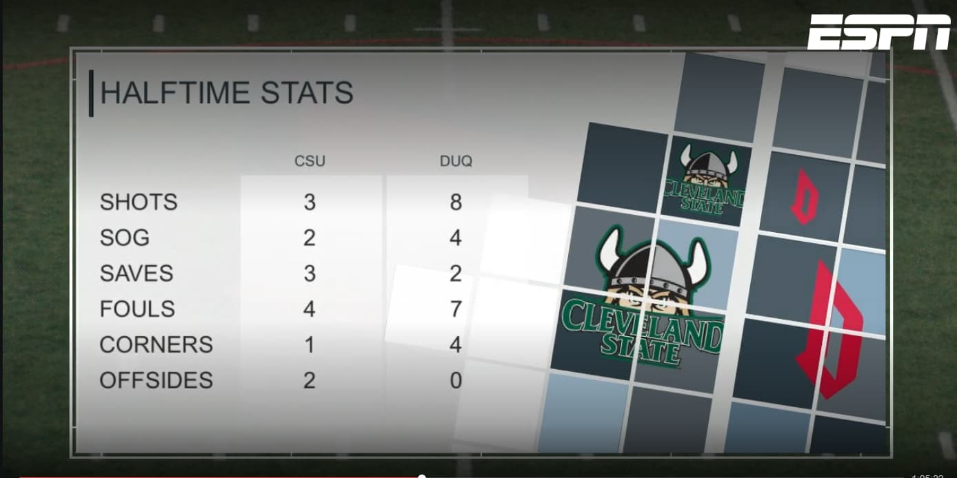

2025-09-04T23:52:19.189794594Z Channel #588 has an active event (Cleveland State vs. Duquesne). Going to start the stream.
I did confirm the game is still going on and I have access
Any thoughts would be welcome.
