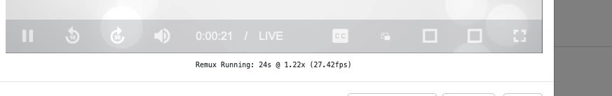

So I have updated to latest build. But I am unable to get a stream. Everything indicates that it is grabbing stream but I never shows up in the web player or channels client.
Screenshot 2022-11-19 at 9.09.34 AM
Screenshot 2022-11-19 at 9.21.29 AM

I appear to be getting a valid token.
Refreshing device token
Refreshing device refresh token
Refreshing BAM access token
And the DVR seems to get a valid stream
There is an active event. Going to start the stream.
Channel has upcoming event. Setting timer to start
Stream for Channel 8003 started on PID:  28
But I only see the splash screen (Your Event will start soon) and it never transitions to the live feed.
This used to work before I pulled the latest build to do the auto refresh of the token.
Try navigating to another channel and going back to the one that just started
Another thing to check is the event actually on. Check play on the espn app Then find that event in Channels. The Event Splash screen should pop up and the event should start playing. That normally takes about 6-9 secs for me.
When I’m on the FTV, the Splash Screen pops up, then the timeline bar pops up. When it fades out, the stream normally starts.
Yeah tried that. It plays on the ESPN app or website, but not through channels. Although it appears that it is capturing the stream as seen by the activity monitor of channels.
Try opening the channel in VLC
