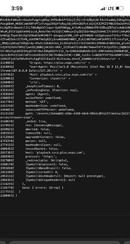

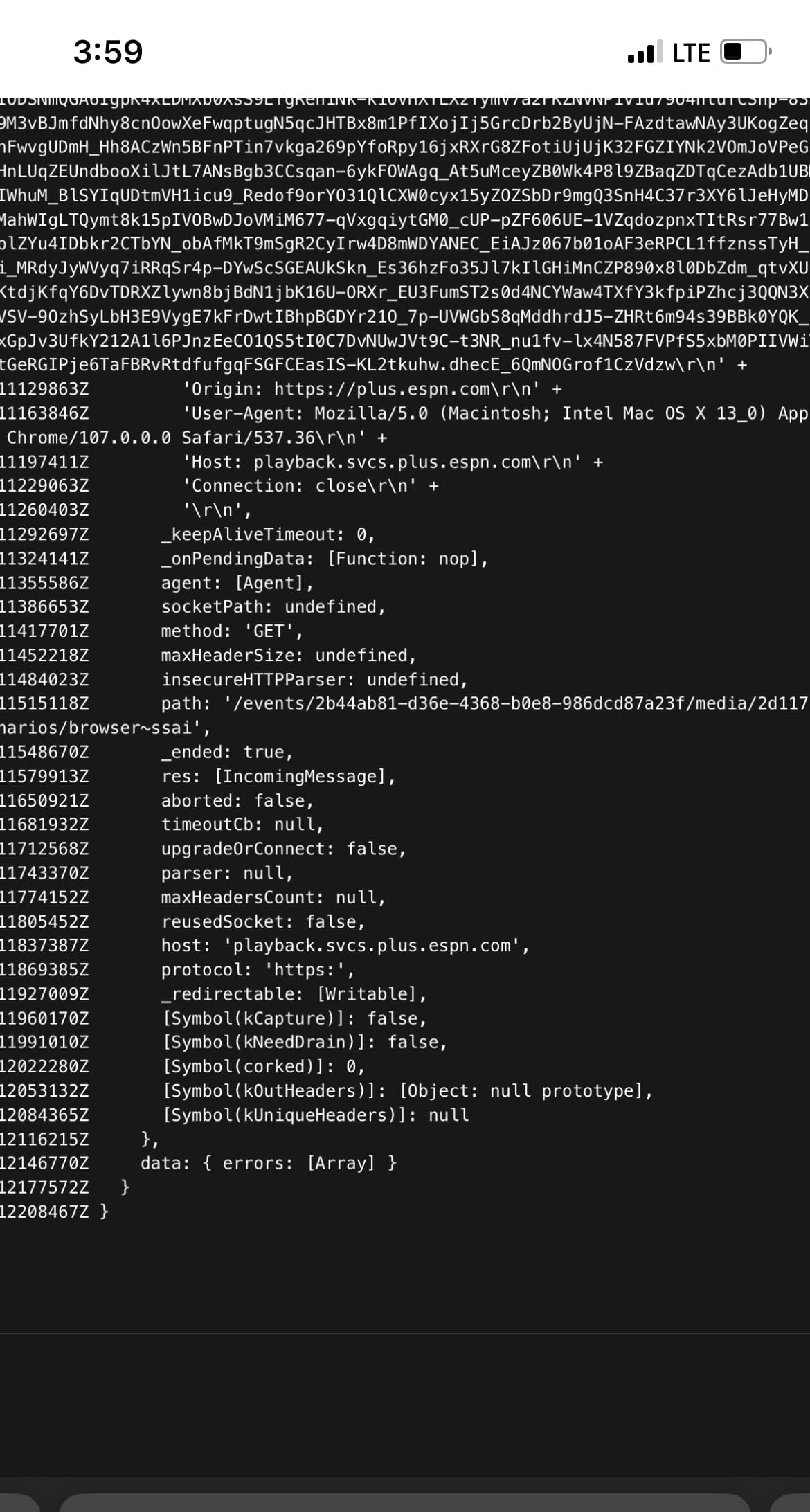

Thanks. I’ve made some progress. Using ev START_CHANNEL was blocking the guide data for espn+ Using default start channel and letting channels ignore m3u has fixed that. The fox channels work as expected but the espn+ content never comes off of event will start soon. Looks like an error in the logs
Looks like the same issue @Ahwman is having. Seems like it's pulling the same User Agent for both... If you restart the container it should get a new one. I'm curious if that UA is bad news or if it's just a coincidence that one is failing for both of you. I'll try running some tests over the next day or so and see if I can reproduce the issue with that UA.
