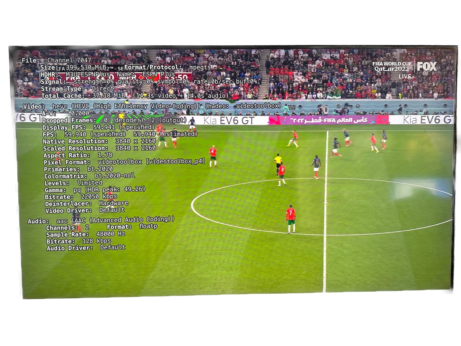

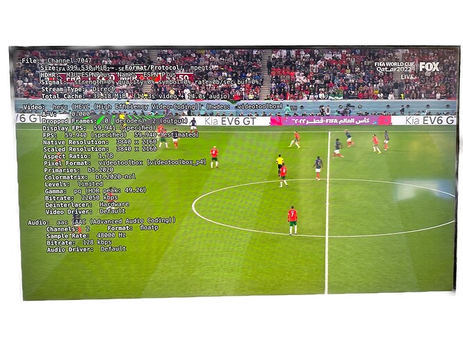

What type of audio are you getting from Fox Sports? Fox claims to support Dolby 5.1 when watching 4k content through their apps. But I have yet to see it:
https://help.fox.com/s/article/How-do-I-play-4K-with-5-1-audio

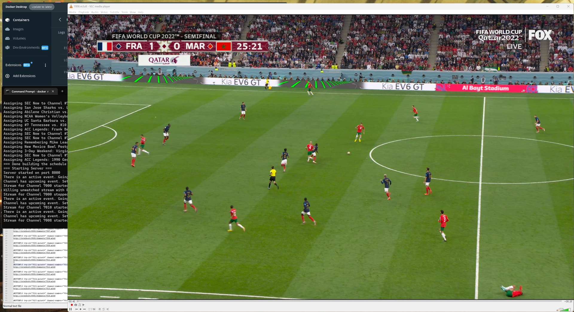

oh my goodness it is beautiful
Just had to pull this up via EPlusTV after seeing your post. It is beautiful, my snapshot doesn't do it justice. My first streamed 4K sporting event. Look at those stats. Too bad the audio isn't in Dolby 5.1.

I'll look at the manifest and see about getting the 5.1 audio!

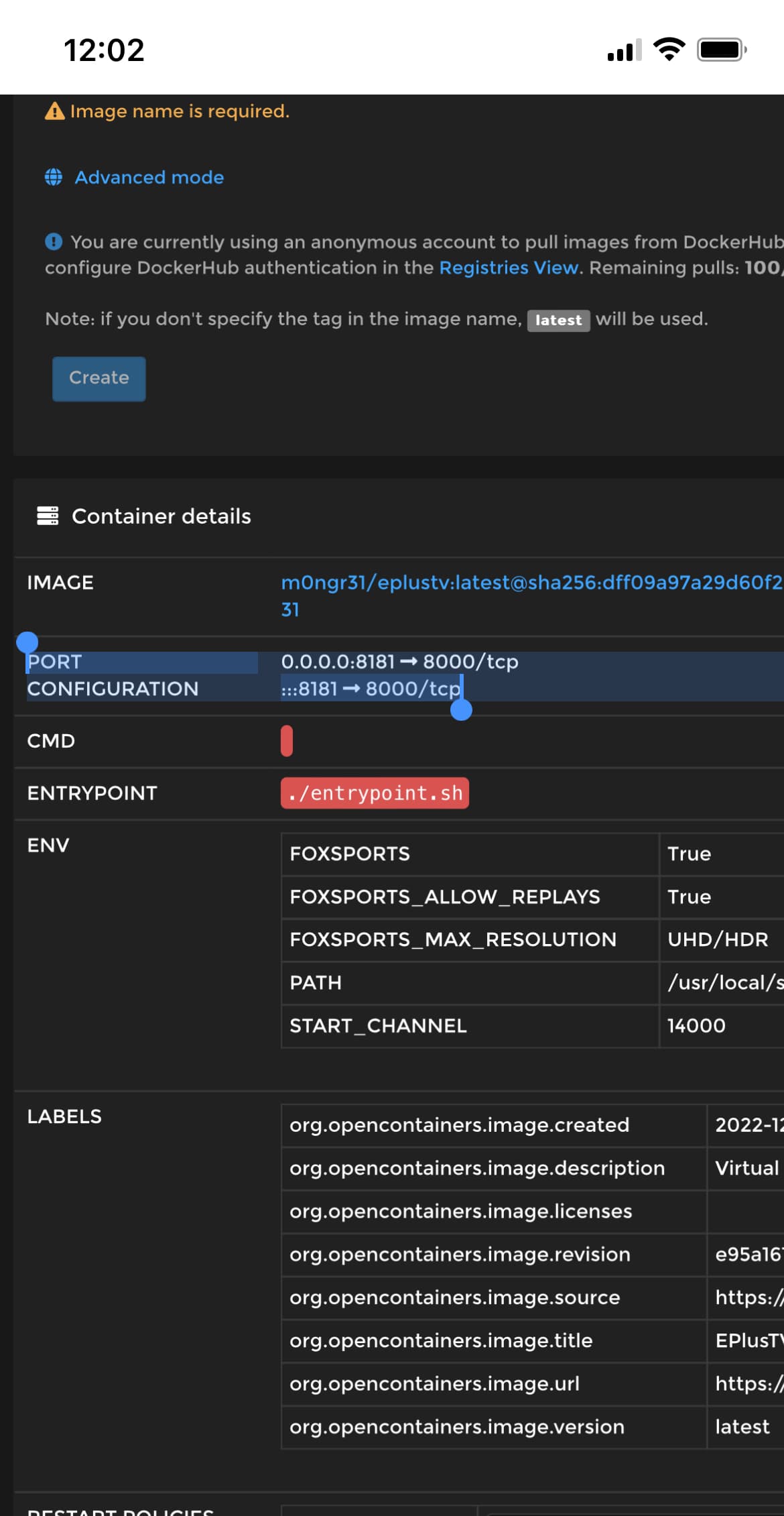

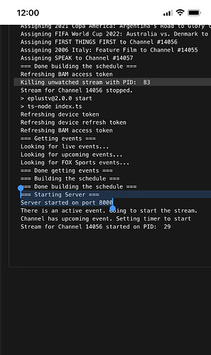

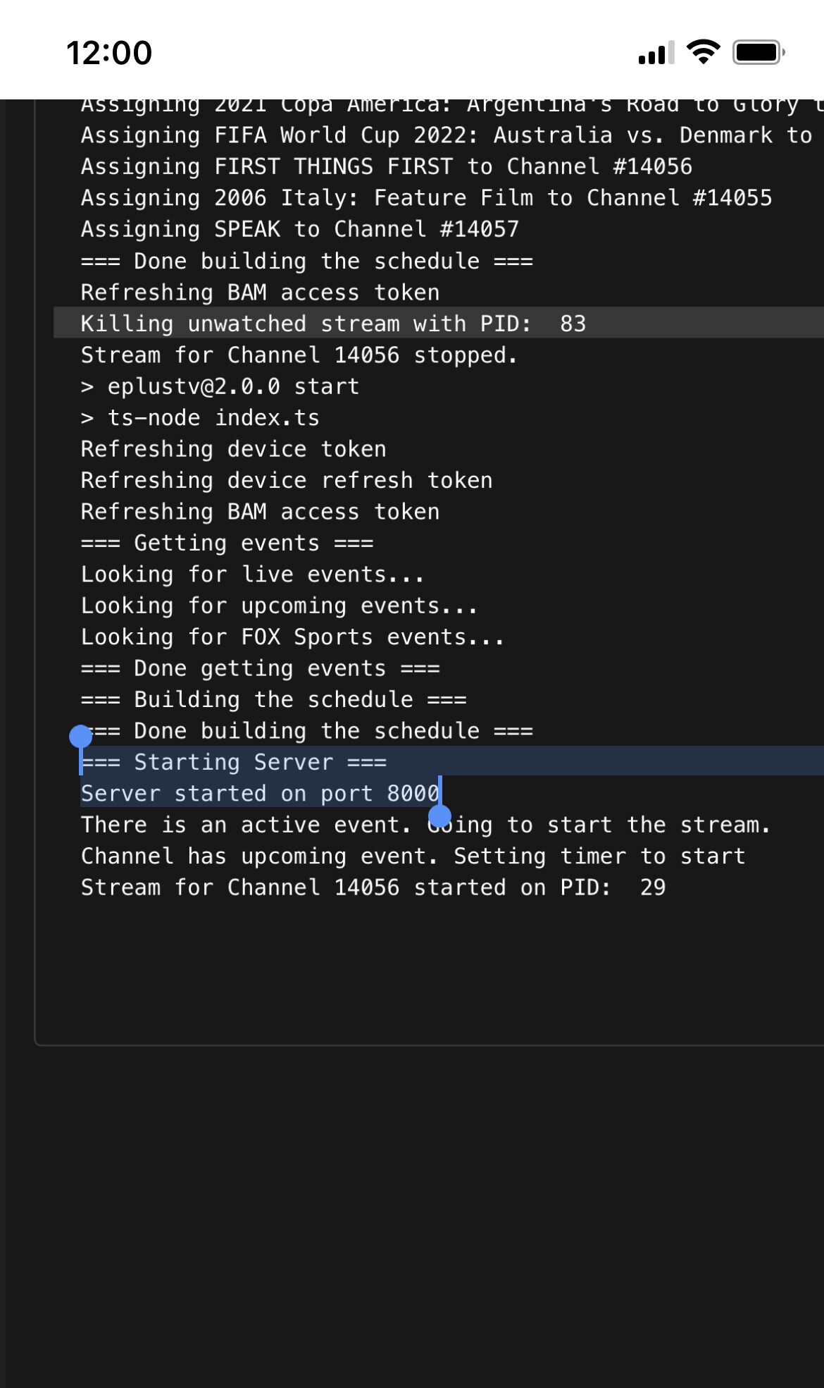

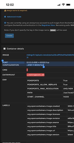

Trying to run this first time, I used this pull docker:
docker run -p 8181:8181 -v config_dir:/app/config m0ngr31/eplustv
It seems it’s not respecting the port 8181. In the docker logs when starting it says the server is starting up on port 8000. I have a different container running on 8000 so I think it’s breaking it. When I use 8181 it doesn’t work at all with 8181 refuse’s connection. If I use 8181>8000 in the container it will add source to channels but I get tuner not available. Any ideas?
The container needs to be 8000, the host can be whatever you want like 8181 as shown in your first picture. Once you have ports setup and have authenticated your espn+ you can try going to the following in a web browser http://< host ip >:< port >/xmltv.xml and it should show the guide data in xml. In your case < port > would be 8181.

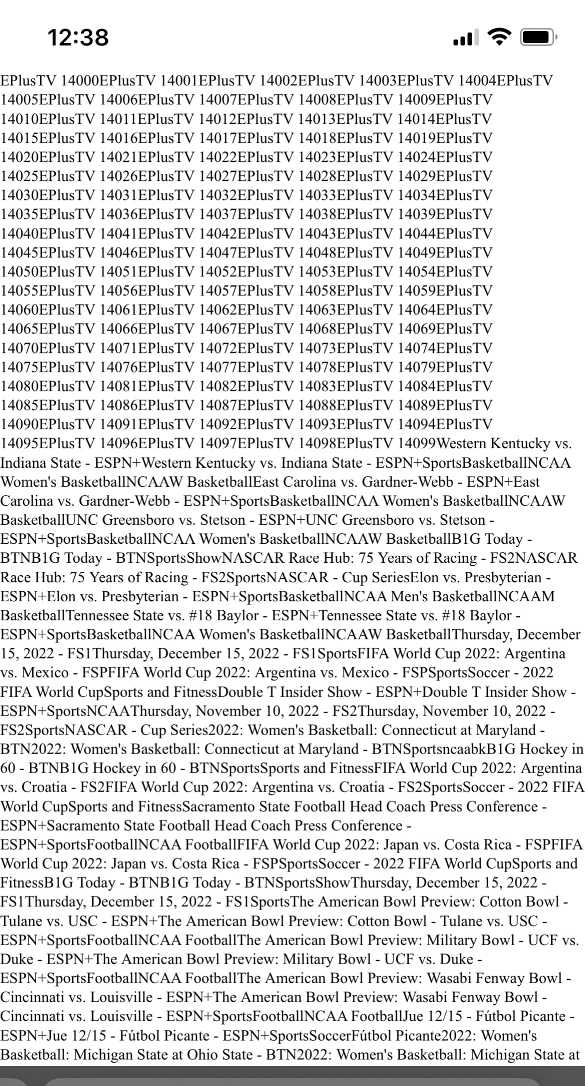

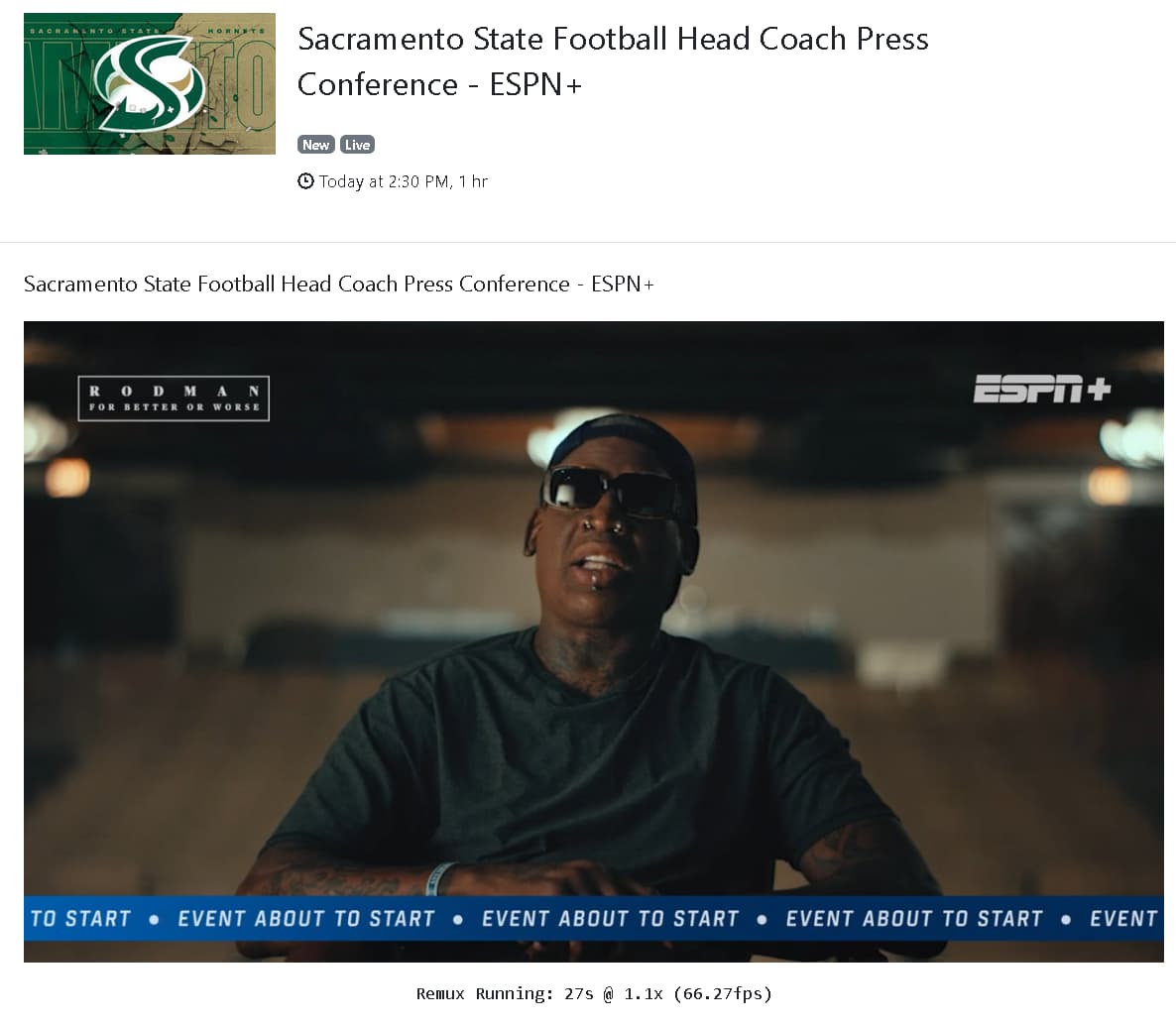

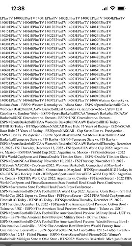

How can I verify espn plus is working? What channel is it on? Seems like it’s pulling epg data for espn plus but I don’t see it in the guide
The only ESPN+ event right now is this press conference. Look for it in your guide and see if it works.
