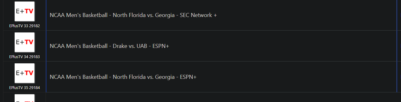

Havine some issues .. sec+ is acting up.
Is georgia working for you guys? ESPN+ UAB works fine. It seems to not be working with SEC+, what do I need to re-enable?
How do I reset ESPN3/SEC+ without resetting ESPN+ -
Author can you make it easy to reassign the tokens for these?
In the tokens.json file, you can delete these two properties: adobe_device_id & adobe_auth. After you restart the container it'll have you re-authenticate
It's not easy for me to reauth espn+ , can you not seperate espn/2/3/sec+/accx from espn+? Like you did for fox?
If you just delete those two properties you won't have to re-auth ESPN+
