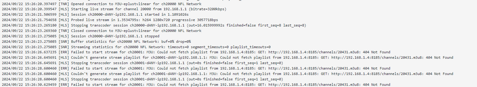

Those logs from Channels look like it's not mapping to the right number or something? Since it's 404ing.

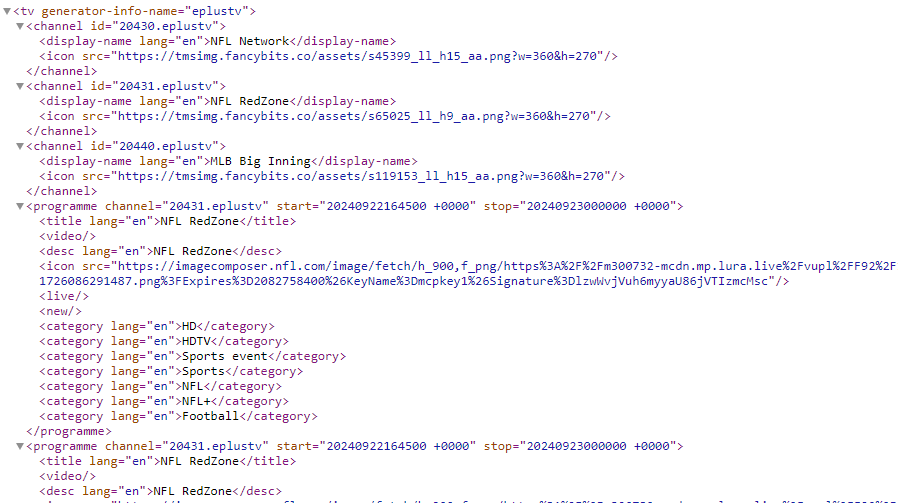

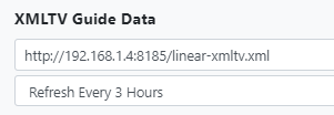

Are you importing the /linear-xmltv.xml as well? Either way though Channels should be able to map what's there from the M3U I think. Unless I set it up wrong
The M3U that my source points to is below. 20430 (NFLN) and 20440 (MLB Big Inning) both work. Just 20431 is the 404.

Also I am importing the linear-xmltv.xml
