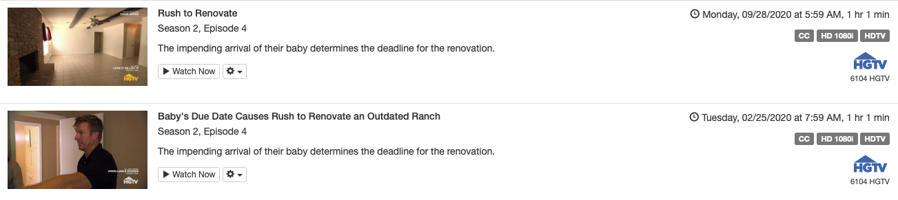

I have a series pass for my wife for "Fixer Upper". I have "All" episodes marked, but it appears to be re-recording episodes it already has, in addition to ones which were missed. There is sometimes a change to the duplicated episode title, like:
Is there any way to make a series pass more "strict" about skipping episodes which are already recorded?
I believe Channels relies on the episode ID in the guide to determine if the episode has already been recorded. Are you able to see find the episode ID looking in the DVR server web console? If so, are the IDs different?
Guide data is a bit messed up and it appears under two shows.
Under https://tvlistings.zap2it.com/overview.html?programSeriesId=SH01727773&tmsId=SH017277730000
it shows Season 2, Episode 4 as both
Rush to Renovate (Aired Jan 15, 2015)
and
Baby's Due Date Causes Rush to Renovate an Outdated Ranch (Aired Jan 15, 2015)
Then under https://tvlistings.zap2it.com/overview.html?programSeriesId=SH02222200&tmsId=SH022222000000
Renovating An Outdated Ranch (Aired Jan 15, 2015)
and
Ok that’s what I suspected. I think you can report the error through the zap2it site.
