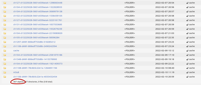

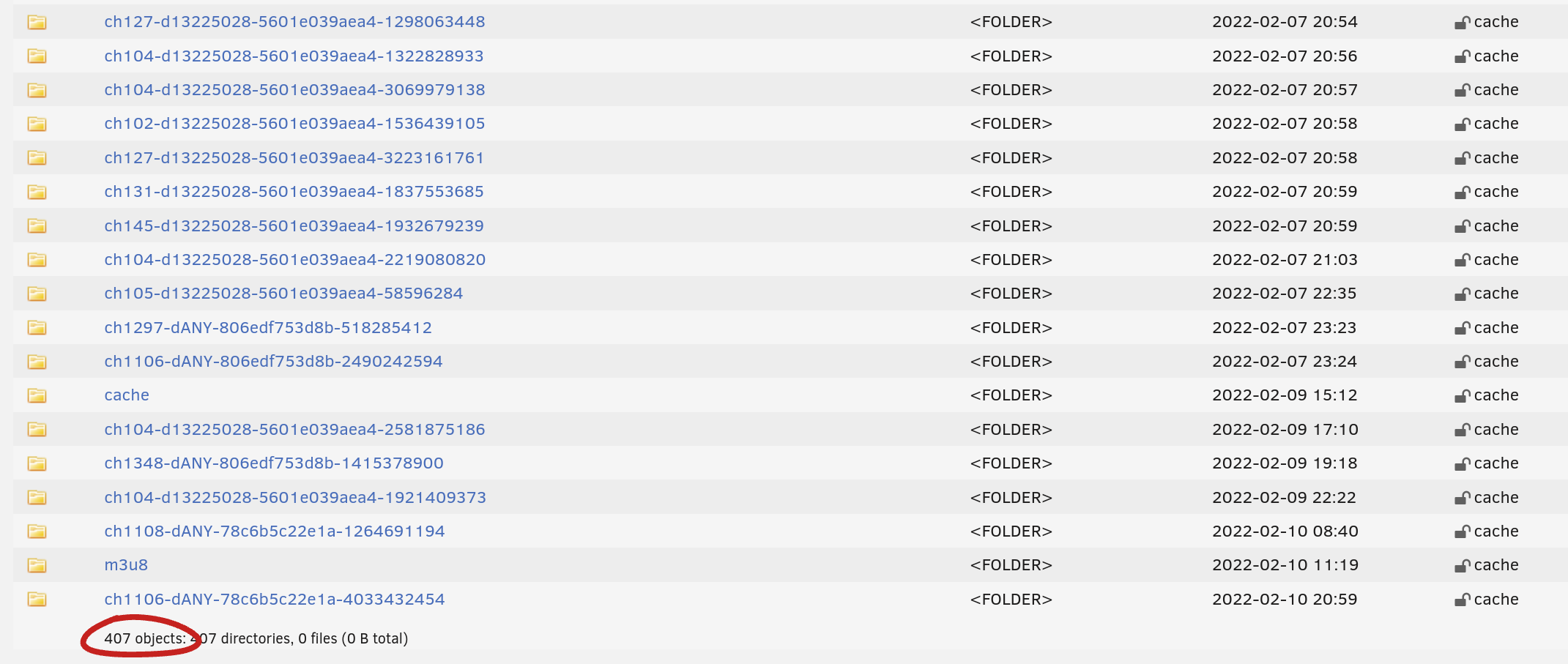

DVR is constantly failing to clean up streaming cache. I have the Streaming directory symlinked to use SSD storage for quick scrubbing with tuner sharing, the read/write permissions are correct. This only happens on Unraid, same setup on Freenas works fine 99% of the time.
2022/02/10 08:40:51.943294 [ERR] Failed to clean up /DVR/Streaming/ch1108-dANY-78c6b5c22e1a-1264691194: unlinkat /DVR/Streaming/ch1108-dANY-78c6b5c22e1a-1264691194/cache: directory not empty
