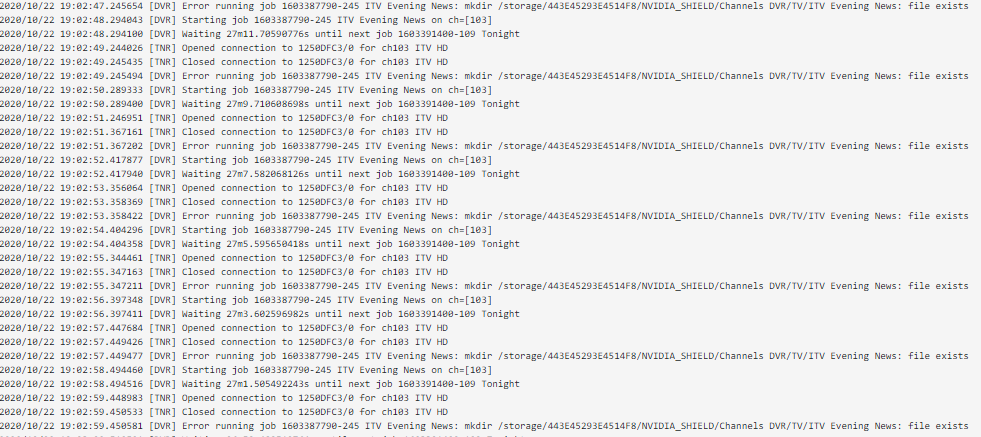

This show has failed to record for 2 days running
Any ideas?
That show starting recording ok after a re-install but now I'm getting the same on a different show on same channel. Any thoughts @tmm1 ?

Must be messed up permissions or something on that directory then. Try renaming it to something else, and then moving any recordings back over if you want to keep them.
Thanks. Will the DVR app automatically create a new folder with same name as old or do I need to copy backup, database etc &/or do a restore etc
It will create a new folder for the next recording.
