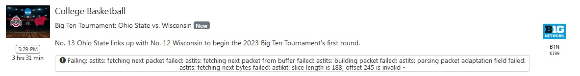

Does anyone know what this means and how it can be fixed so we don't miss this game? Logs submitted.
Just what it says, that the next packet couldn't be retrieved. Since it was claiming the buffer actually held it, and the buffer is on your drive, it most likely means your recording drive is failing.

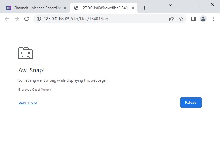

Okay thanks for looking at that. I already submitted logs from the troubleshooting area, how would I go about doing what you ask, exactly?
What can I do to help solve the problems?

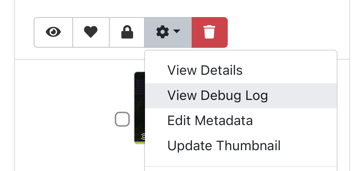

Right click file save on the debug log link and email to support
