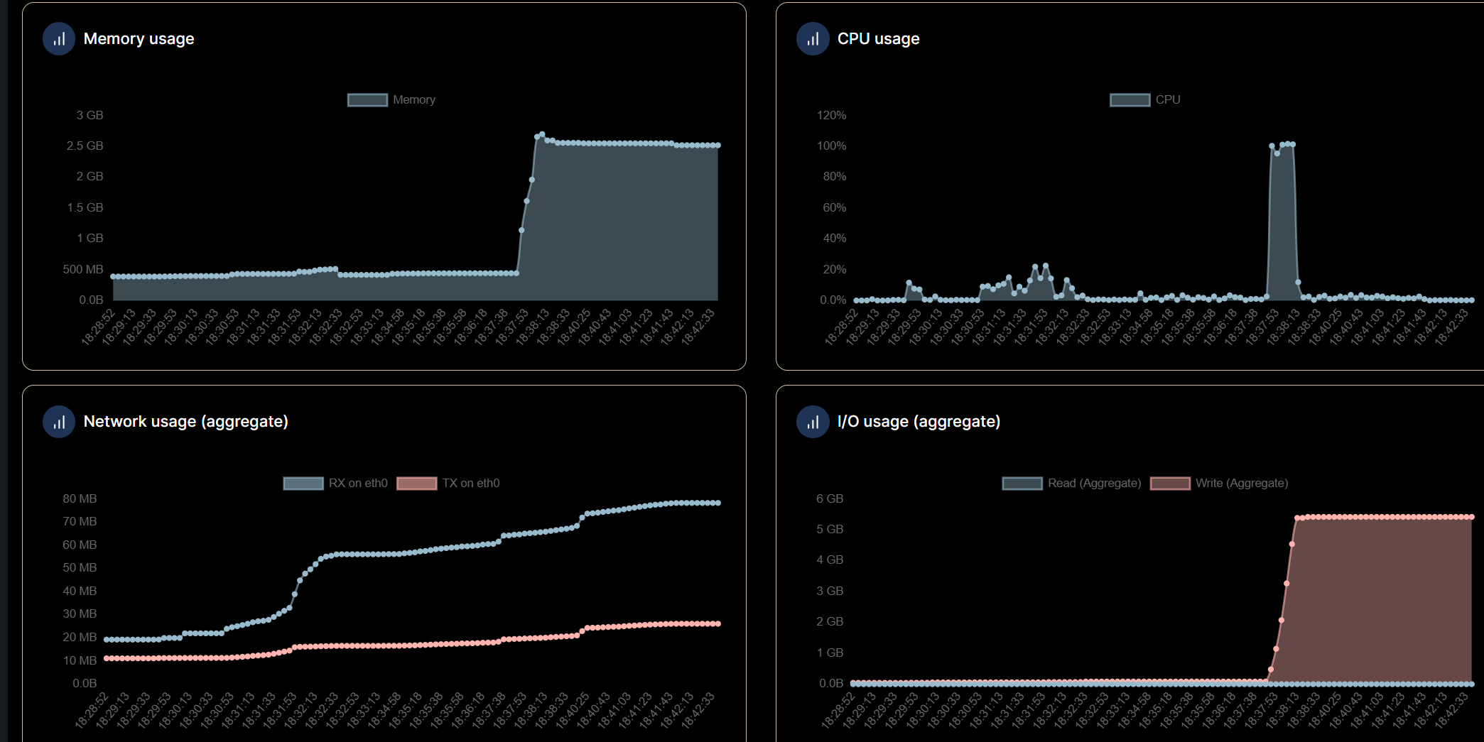

Yea....this what i mean. (think my previous issues was running out of memory.
As i had the vm set to 2gb, not its at 4gb.)

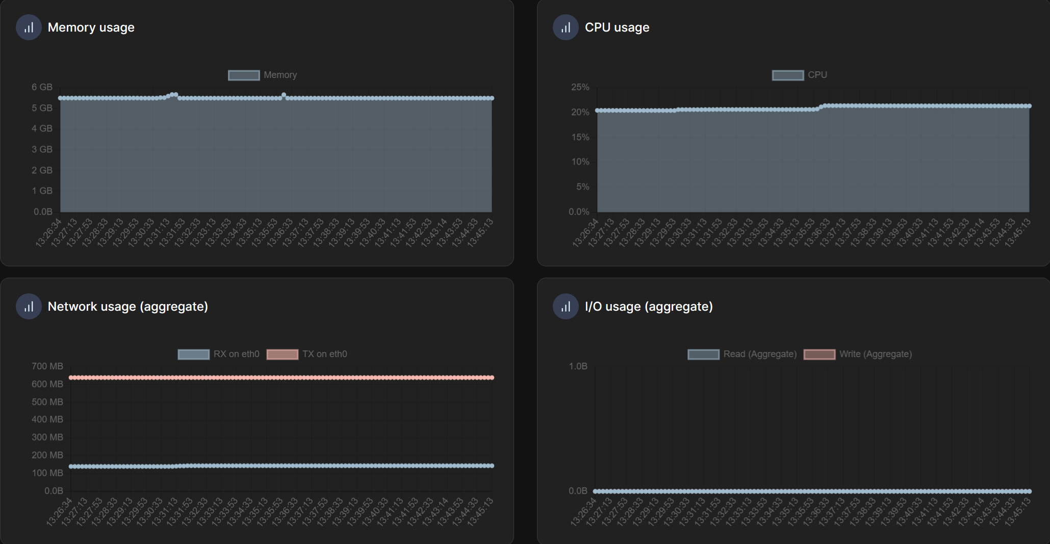

Here's the 4 from Portainer
Notice the 4 lines with gunicorn at over 1G each?
@KineticMan do I have some runaway processes?

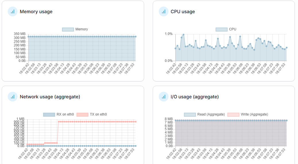

So, due to the issue with the memory above, I did a quick install on my old linux server and noticed normal mem usage...

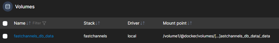

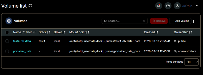

So, the question is, the database was saved? where?
wherever your blind mount is setup is where the DB is stored. so u probably didnt delete that

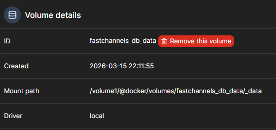

Is that what the Volumes are in Portainer?
In my tests and wiping of things to start fresh, i have always deleted this.
Yep, for me it's
brave_screenshot (1)

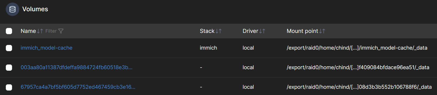

No, it's not the same... I'm using a bind mount, so dockge actually creates a folder and then save all the container's data in that folder... I don't use volumes, actually I still have one container left with 3 volumes attached to it, from when I initially set up Podman on my server...
This was before I understood the difference between the volumes and the bind mounts... binds just works better for me... different folks, different preferences...

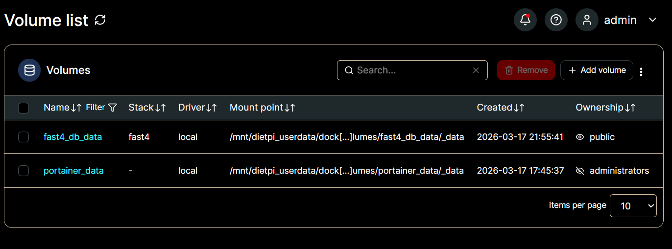

Just for ref, here's my volumes in Portainer:

Deleting the container, image, stack, compose, etc. will not delete the host bind mount data directory.
As you found out.

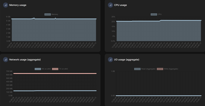

Just as a comparison, here's my Portainer stats for this container. Windows 11 Docker Desktop.
