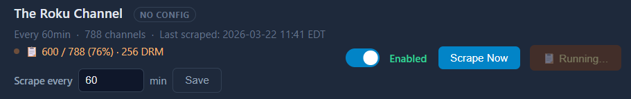

I think Roku just went all DRM- investigating. Anyone else having issues there?
Edit- false alarm but exposed a bug. Getting update out today hopefully. Roku may be unavailable until update fyi.
i'm still seeing the this old house roku channel and its streaming - so at least something hasn't gone drm
Seeing some channels are DRM and some are not. All BBC Channels and Cinevault are DRM, America's Funniest Videos, Brit box are not. Will keep checking.
Ran an audit, looks like almost half are DRM:
Every time I attempt to run an audit on the Roku Channels, it crashes out after 20 consecutive errors.

Yep working on that now.

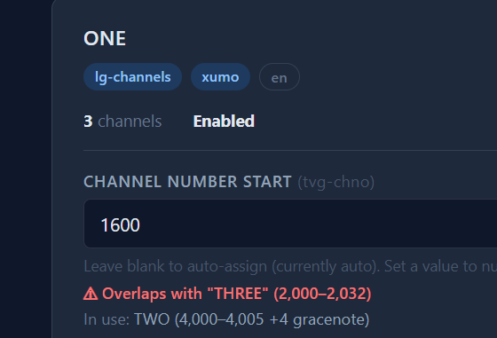

Notice on feeds, a Overlap warning. What is this checking for?
As my feed it warns on does not overlap.
Only 3 channels starting at 1600, so 1600 - 1602.
The other feeds are starting at 2000, and 4000.
Screenshot 2026-03-22 144758
Note. All channels in each source are disabled save for the ones i am including in each feed.
So, i assume i can safely ignore this warning?
I should probably check into that. It won’t hurt anything as Channels won’t allow duplicates.
Edit on version 2.1.2 Roku should work now
