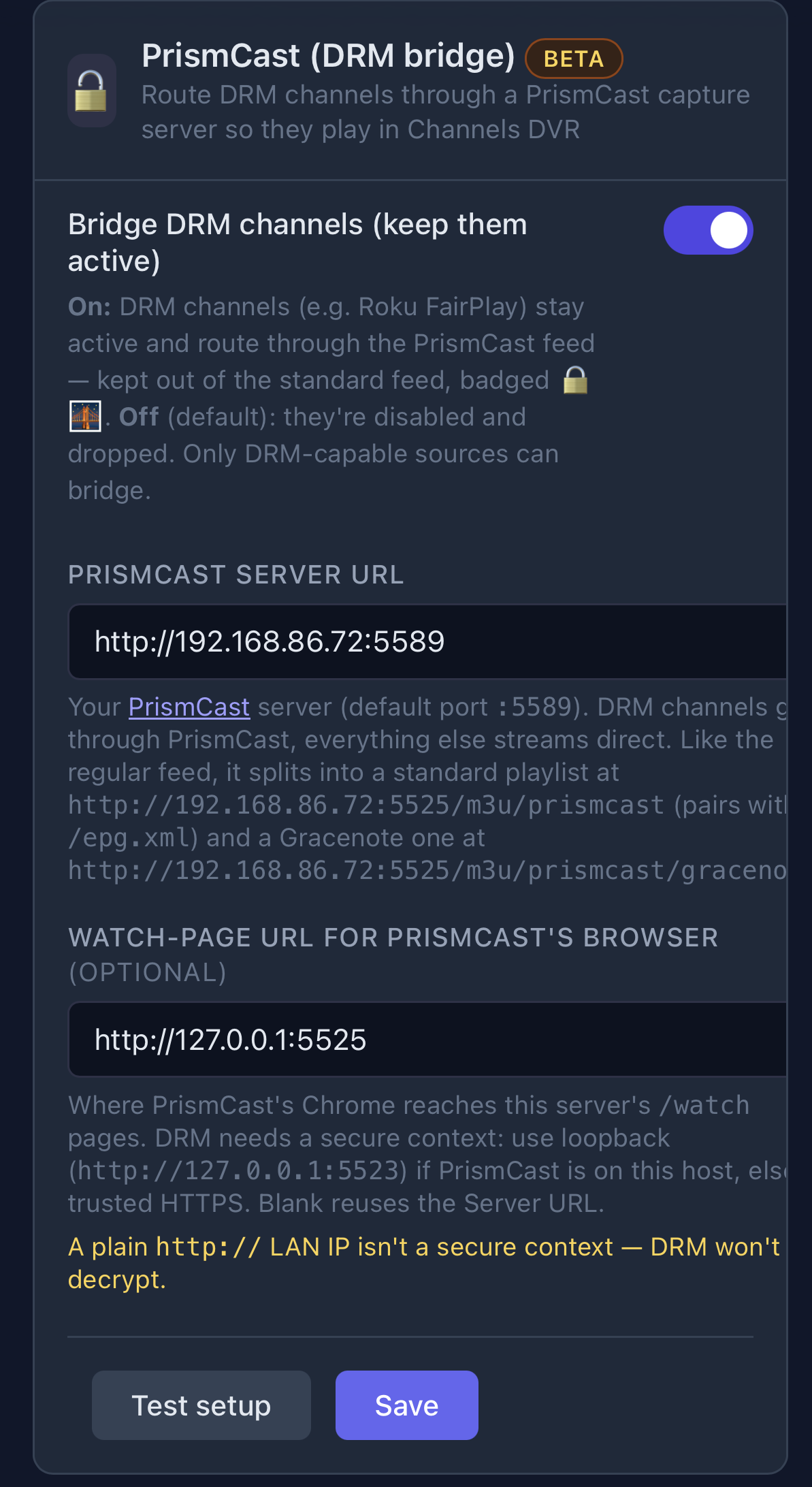

I can't get the loopback to work... I've tried every combination of IP/URL http:// and https:// and nothing seems to result in a successful test. What am I missing?

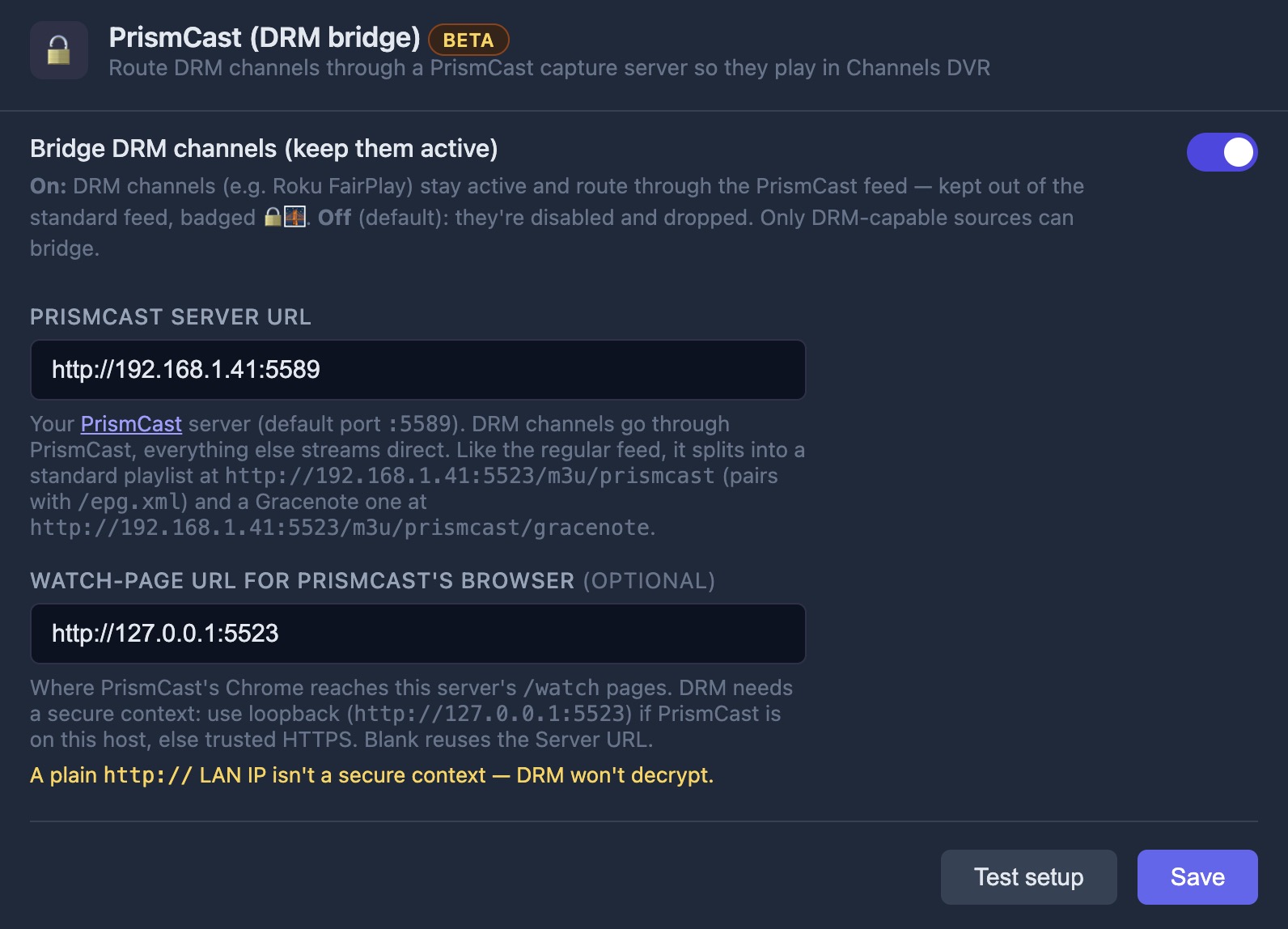

Here’s what mine looks like (again, assuming Prism on same server as FastChannels)
Port 5589 is my PrismCast and 5525 is my FastChannels (normally 5523 this just my test container)
On the PrismCast server, I get "127.0.0.1 refused to connect." for the loopback... everything else looks like your setup.
screen shot your settings pls
same as yours...save for the 5523 vs 5525
looks good. It just occured to me what's likely happening-- do you have Prismcast setup inside a Docker container?
if so, you need to update your compose to show this so loopback works:
network_mode: host
That was it!!! Thank you!
I suspect you won't be the only one with this issue -- I'm going to improve the "test setup" modal to include some better instructions. glad its working!
