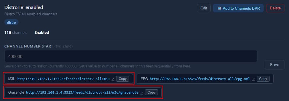

There are some (like this FastChannels) that offer a gracenote playlist (has tvc-guide-stationid=) and a non-gracenote playlist (needs xmltv epg)

to be clear- you can just force any channel to use Gracenote if you wish. like, if you liked a channel that Tubi and Pluto have, and you wanted to use the Pluto version of it but the Tubi one shows Gracenote ID (it's automated from the source or some I hard coded), you can just add the Gracenote to the Pluto channel. make sense?

If the source is set to get XMLTV guide data, you cannot override that in the playlist m3u using the tag tvc-guide-stationid=. You can put it in the playlist m3u, but Channels DVR ignores it.
In the two sources setup, one source has only channels with gracenote guide data as specified by the tag tvc-guide-stationid= in the playlist m3u. You must not specify an XLMTV URL for this one.
The other source has only channels that use the provided XMLTV guide data.
So in your Feeds tab in FastChannels, you have two playlist sources for each feed. One for channels with gracenote guide data and one for channels without gracenote guide data.
Look at the contents of the two playlists.
