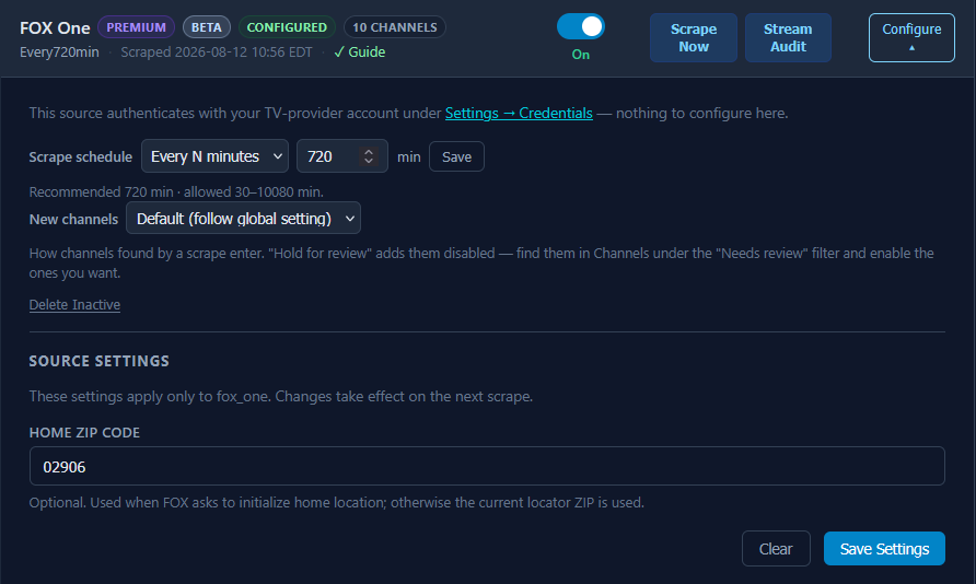

  • I don't seem to have my local FOX station on FoxOne, even though I definitely put in my zip code...

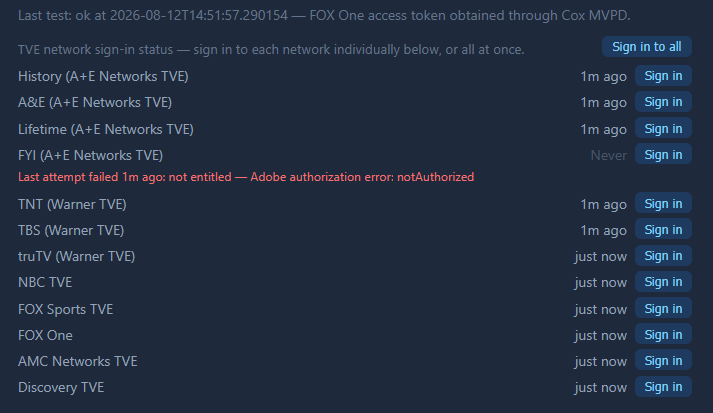

  • There is a name mismatch between the FOX Sports TVE login and the FOX TVE source.

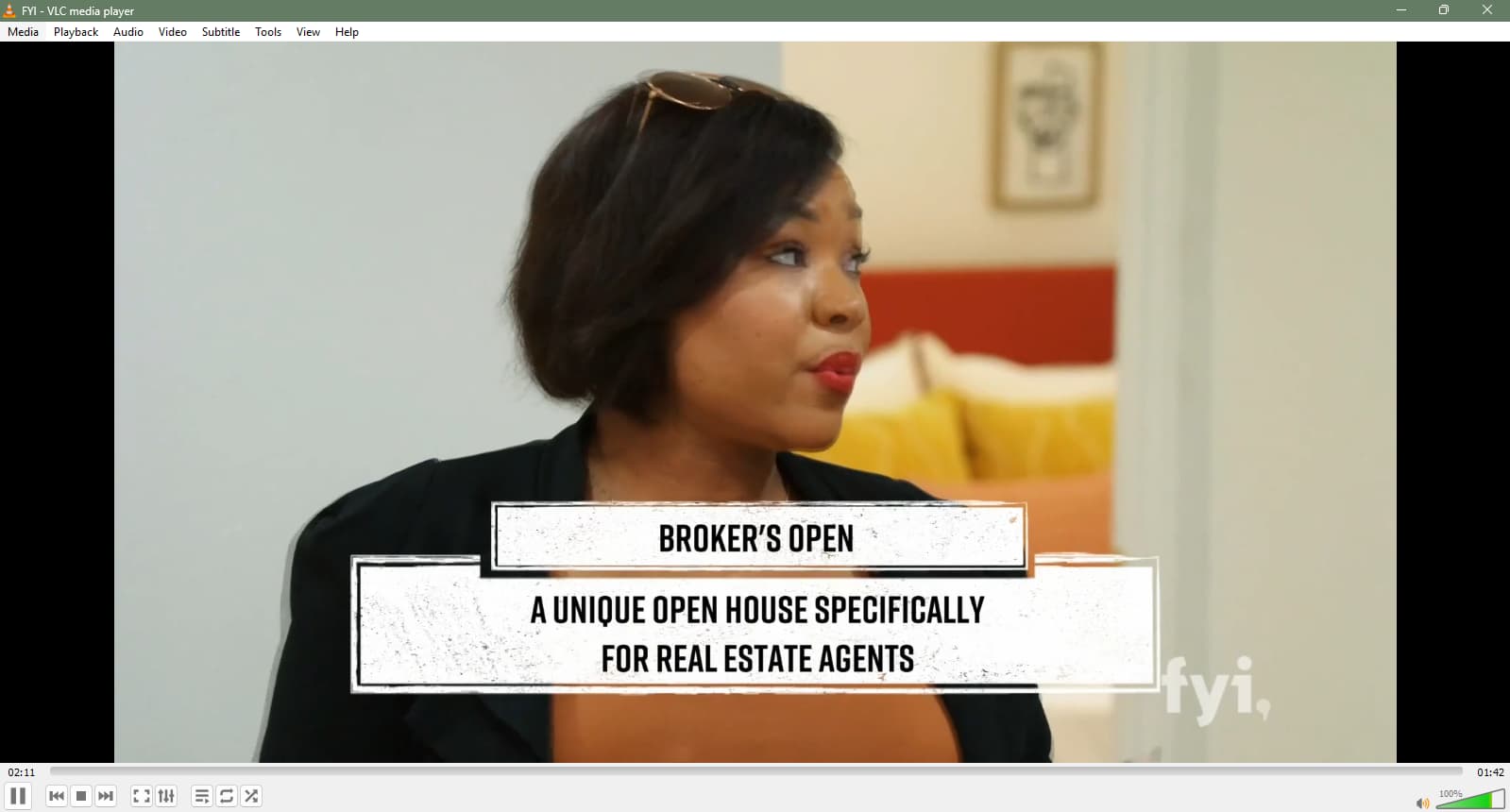

  • Even though FYI gives me the notAuthorized error, the station still showed up after I added the A + E Networks. More so, even though I see this in the logs...
    2026-08-12 11:57:23,646 INFO     app.routes.play: [play] request_id=b803eab32b3e80a7 ip=172.24.0.1 source=aenetworks_tve channel_id=fyi channel_name=FYI
    2026-08-12 11:57:26,262 WARNING  app.scrapers.aenetworks_tve: [aenetworks-tve] MVPD not authorized for fyi: Adobe authorization error: notAuthorized
    ... it still plays!

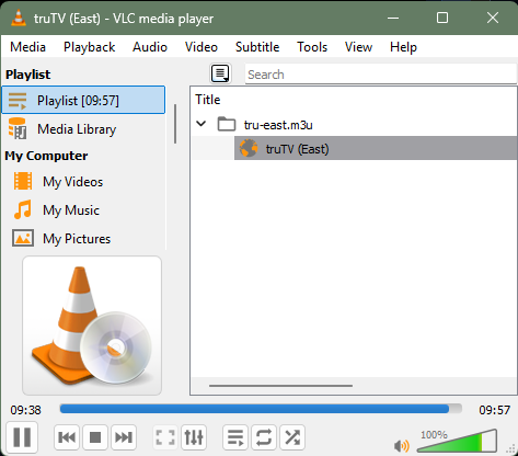

  • None of the Warner TVE stations would play for me in any situation I tried. They all just started playing in the future and went nowhere else:
    Also, the Warner TVE stations will not show up on standard, Gracenote, or native playlists. They only appeared on the PrismCast ones.
