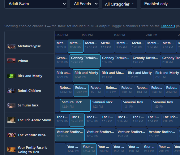

Does Adultswim have EPG data? Trying to get guide info on Rick and Morty channel
fo sho

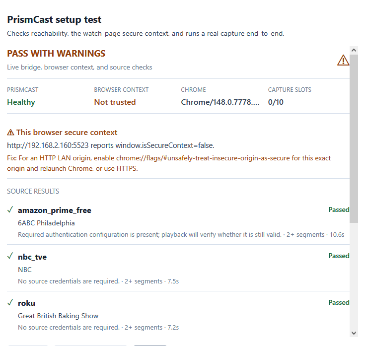

In the past week or so, I 've had trouble with the prismcast bridge setup:
In particular, the browser secure context. However, I do have the chrome flags set up as specified. I'd set that up previously and didn't have trouble with the Prismcast setup until recently. Is it possible that FastChannels isn't recognizing that I have it set up?
In case it's relevant, I'm running the FastChannels admin from Firefox on one PC , and both Prismcast and my FC server are on a different computer in my LAN. I tried running the setup test from the PC that houses both servers, and the same "browser secure context" warning appeared.
However, as you can see from the screen shot, Amazon, NBC, and Roku streams all passed. Furthermore, in case it's relevant, I can view my video on my native Prismcast feed in Channels, so I know that aspect is working as expected (just updated Prismcast to 1.11, but the issues was present before that and remains present now).

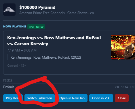

On the computer that houses Prismcast, open up Chrome on that PC and go to FC Admin page. Then go to admin/channels or guide and find one of the DRM stations.
Then go here:
All that Prismcast-bridge does it play the "Watch Fullscreen" link. If you can get it to play on the same Chrome instance that Prism is on, then you're in. What type of computer is your Prismcast server on?

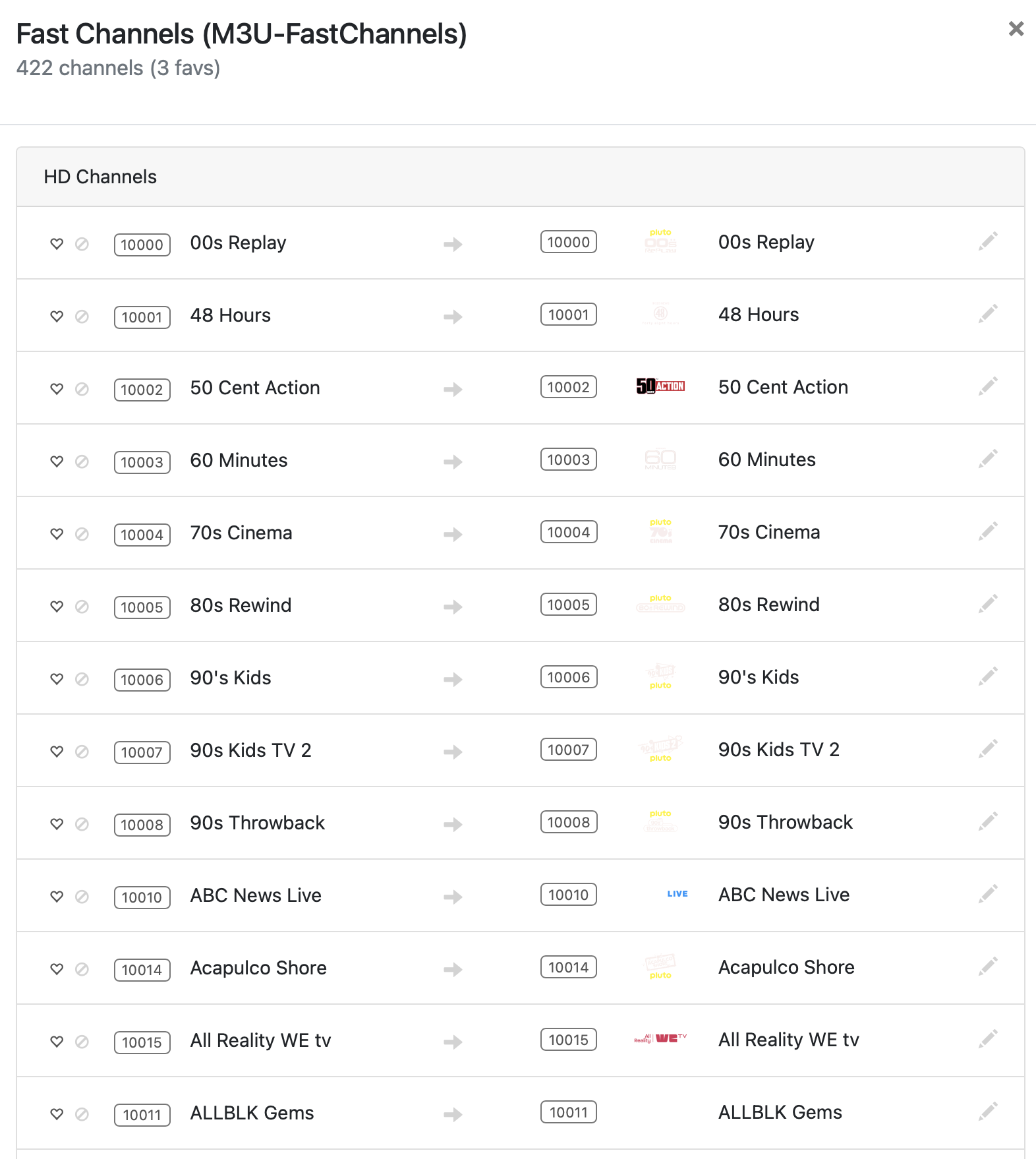

Is there a way to change the individual Channel Numbers back? I liked the way the old Pluto EPGs worked where the channels were grouped by Genre and not in alphabetical order. Thank you.

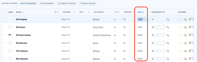

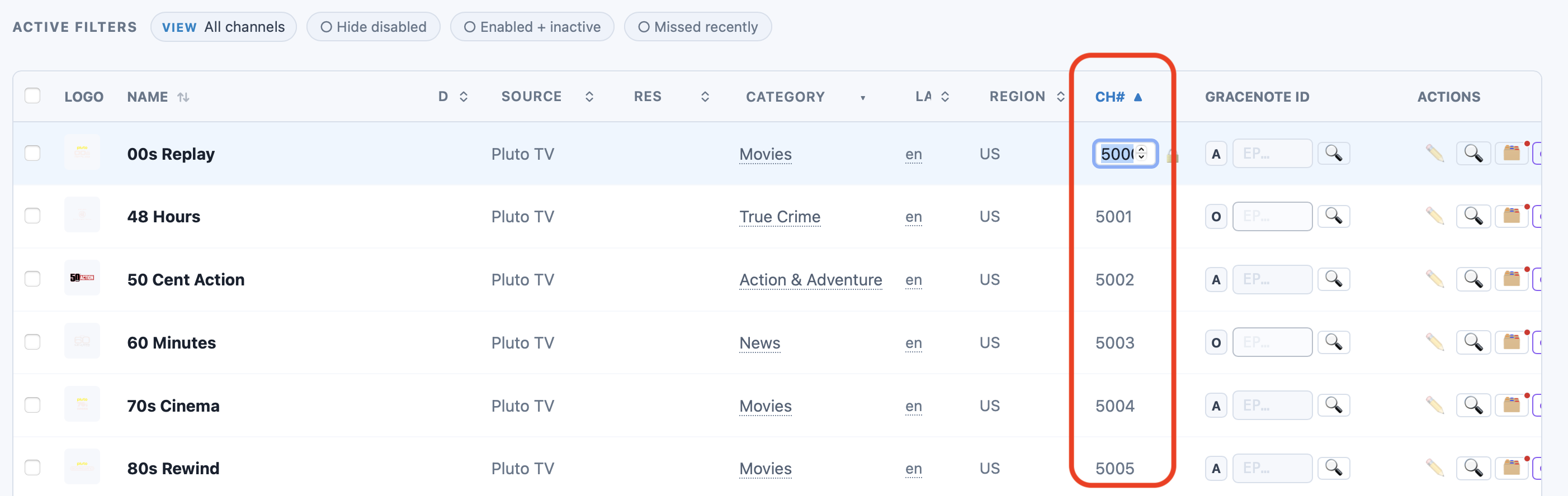

do you mean the tv-channum that gets sent to ChannelsDVR? If so, yep - from Feeds you can customize any of those numbers to your liking.

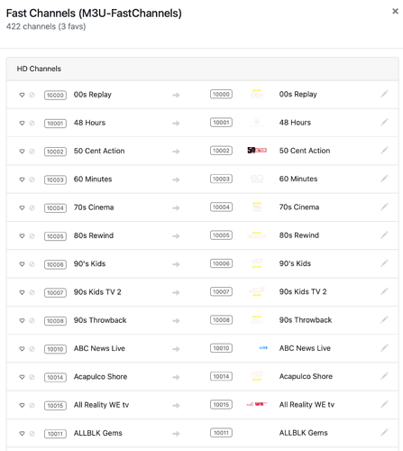

Hello KineticMan,
I would like to go back to the channel numbering scheme from the older pluto-for-channels. Where the channel numbers were grouped by category. So all the Movie channels were up top, the Drama channels were together, etc.
The Fastchannels UI sets the channel numbers alphabetically by channel name.
I see that you can change the individual channel number, but remapping 422 channels would be cumbersome because they're all out of order.
I would like to know if there is a way to go back to the old channel numbering scheme before I go and start remapping the channels one-by-one.
Thank you for all your work and for answering questions!
Sincerely,
Retrostream

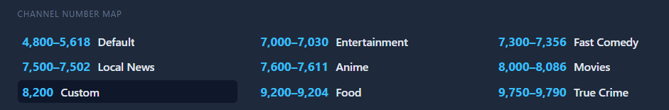

I understand the ask, but that'd require myself to re-code how sorting works by each source - and that'll get hairy real fast.

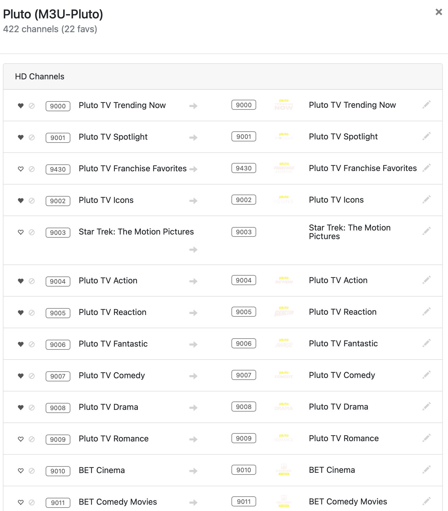

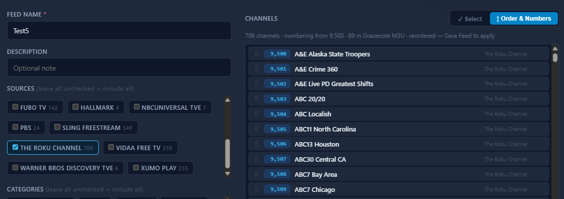

This is a good example why I recommend thinking differently about CDVR sources-- don't just add "Pluto" to Channels. Add unique feeds-- like Movies, Drama, News. Then, you can combine sources (like Pluto, Samsung, Xumo) all in one feed- but selected by category.
As example, here's my personal setup:
