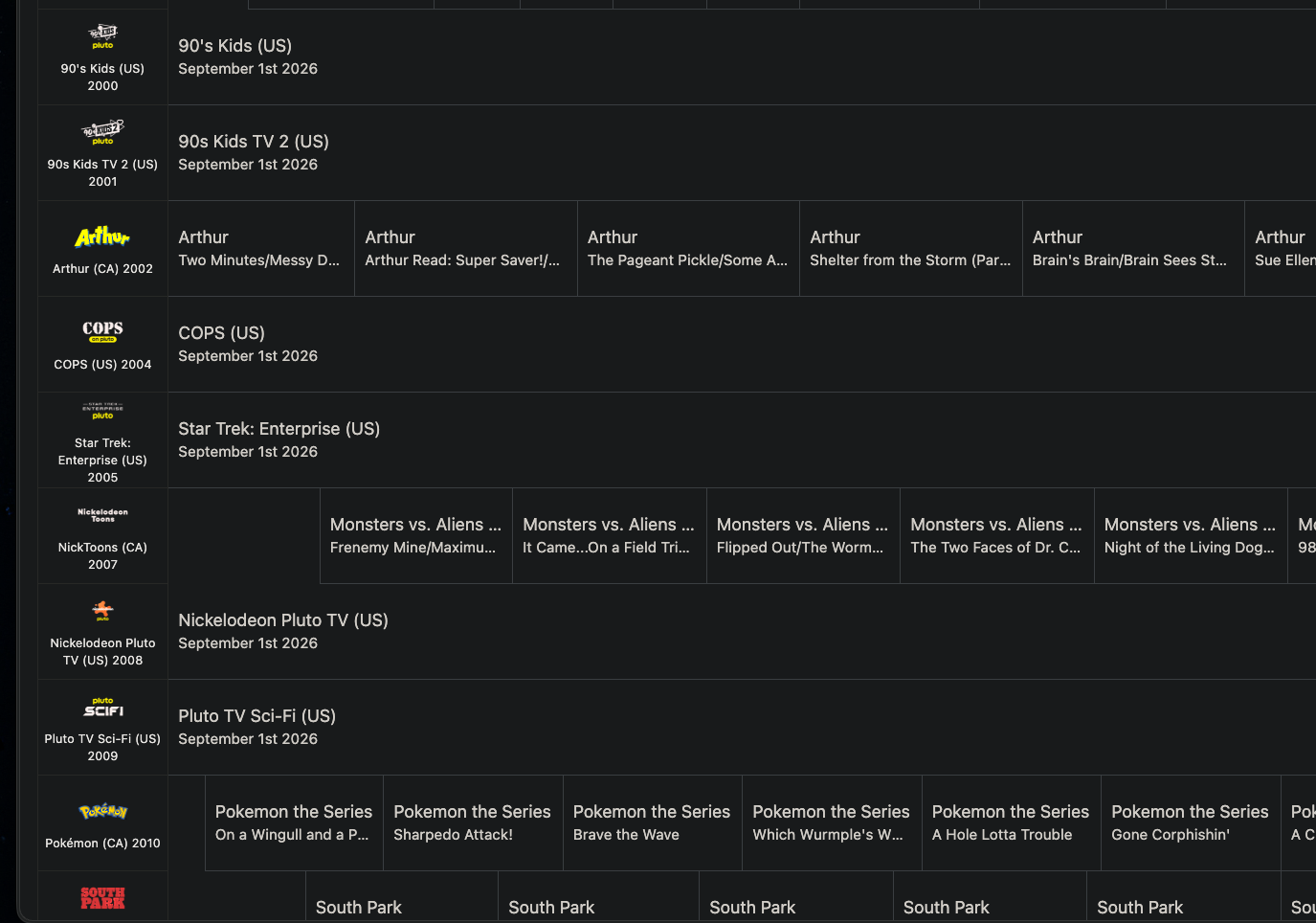

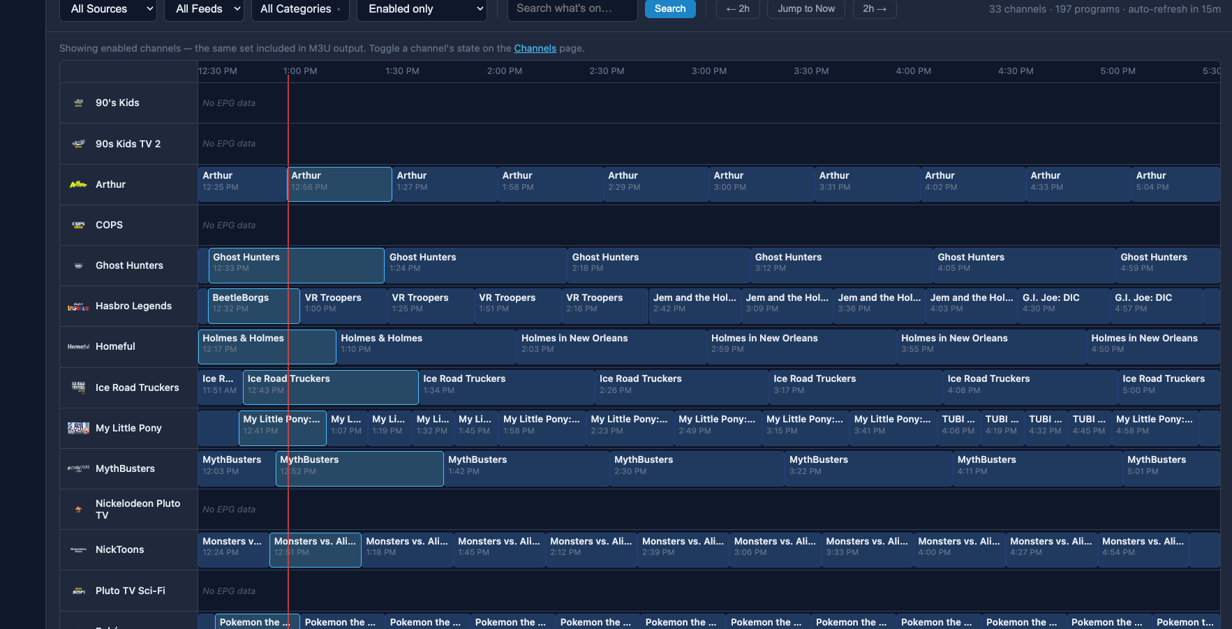

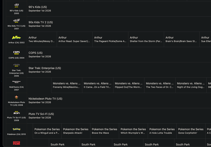

Notice mostly blank guide data fro many Pluto channels now in FASTchannels. Manual refresh not fix it

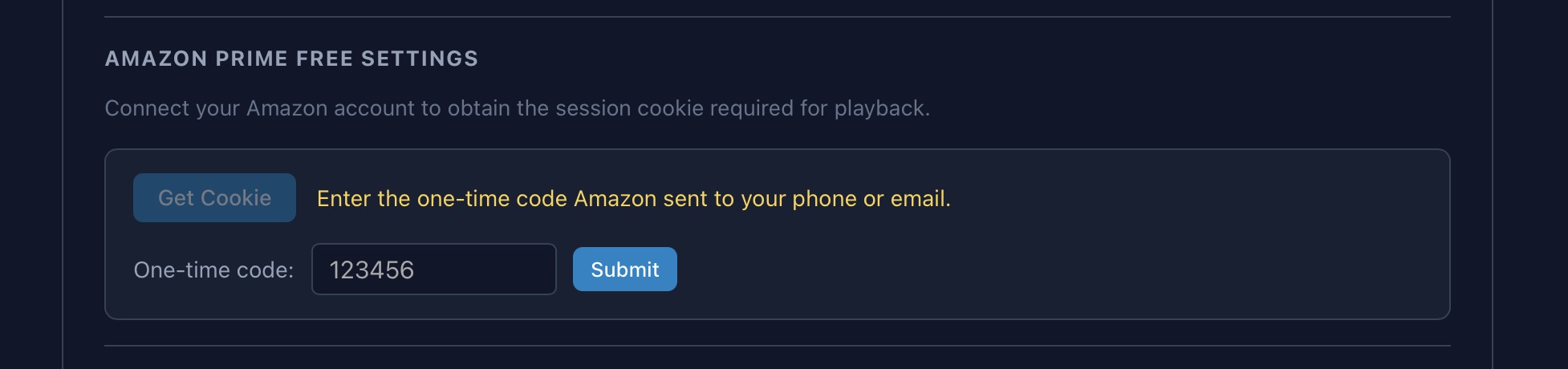

I don't think I ever had 2FA in there for Amazon? Are you not able to sign-in?
Also, for the premium channels on Amazon - I don't subscribe to any personally so unable to test. I have it set to only scrape everything - and it only saves the channel into FC if it has a "playbackEnvelope." So, straight guessing here- if you subed to other channels, it should scrape those?

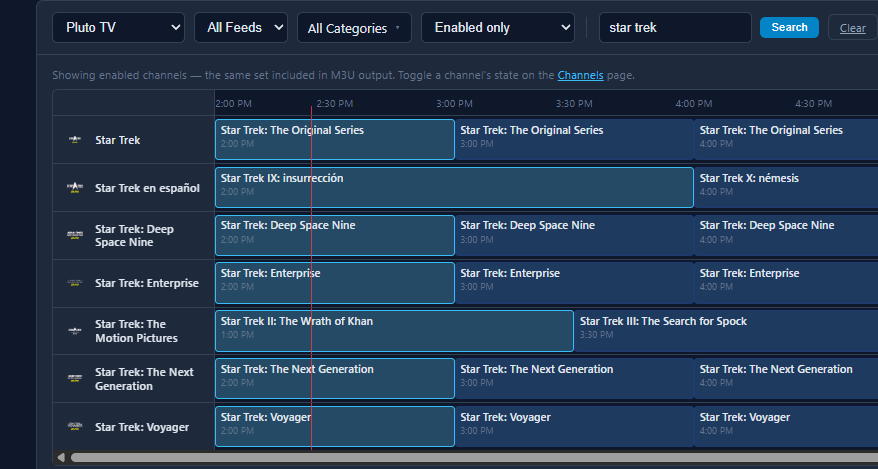

And now all the Star Trek pluto channels are gone from Channels...
I don't understand.
They show in FASTchannels, still in feed, still show as in Lineup in sources in server, even show in my Channels collections as still existing. But, when i view the Guide sorted by the collection, its say no channels match.
Other pluto channels, no data.
They have data on the Pluto TV website.
But FastChannels is not getting any data....even did force refresh.
Had switched in server source settings to HLS, instead of MPEG-TS to see if that affected anything streaming wise, but i can't test anything, when the bloody channels disappear. lol. They were there yesterday.

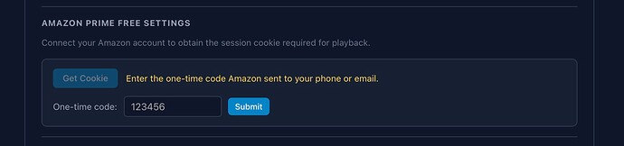

You did and still do, apparently. I wasn’t able to login with my creds yesterday because I had 2SV enabled. When I tried it yesterday I kept getting an error message with a link to an amazon.com page to enter the OTP. I ended up disabling 2SV and then was able to login. I reenabled 2SV and completely disabled the Amazon source in FC just now to get the exact wording to report here, but after I typed in my creds, FC asked for the OTP. Strange, and as I alluded to in my original comment, I remembered FC asking for the OTP previously.
Re: premium channels, yes, they scrape. I currently sub to a few channels within Prime Video that have live feeds… YES Network, MLB Network, Tennis Channel, and a few movie channels. My biggest complaint with prime video is the lack of DVR or replays, especially for certain sports, but FC and the PC bridge now solves that problem. :star_struck:
FYI, many of the premium channels that have live streams on prime offer free trials, if you ever wanted to test them out yourself.

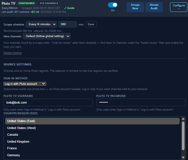

I have no idea what you did! I just did a fresh scrape on Pluto and I see them all too. Do you have a non-standard Country/Region feed perhaps?
