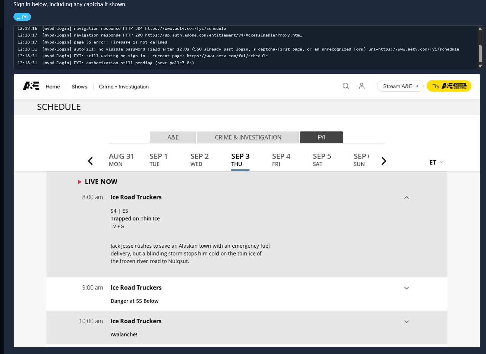

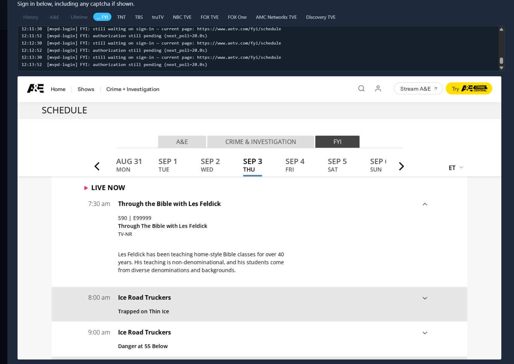

Thanks @KineticMan. I'm testing now and getting stuck on FYI's login, been on this screen for 5+ minutes so far. There was a popup that I clicked Next on, sorry I didn't take a screen shot and don't recall the specific question. I'll reboot the container and see if I can capture more of what's happening.
EDIT - Restarted and tried just to do FYI vs all, but getting this (no prompt showing up now):
