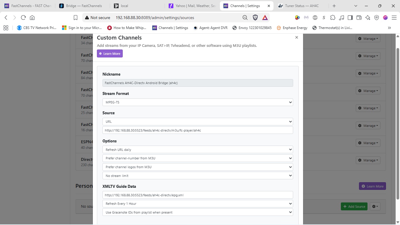

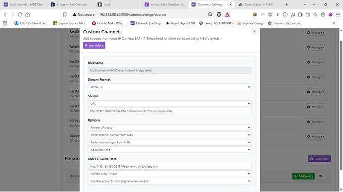

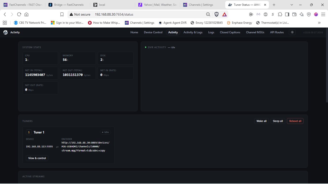

Okay, so now we're back to the tuner being in use. Are you confirming the tuner is available in ah4c, and that your CDVR "virtual encoder" isn't in use before you try these tunes?
I see you're trying to use the new feature for mixing Gracenote and XML data in a single source. @KineticMan are you supporting this in FastChannels bridge M3Us yet?
Yes, in the Activity section of ah4c it shows idle before I tune.
Ahhhh. Haven’t tested that yet. Good catch.
The mixing of epg sources defaulted to the new feature, I didn't knowingly set it.
Hmmm... I've never seen ah4c report a tuner wasn't available, if it was.

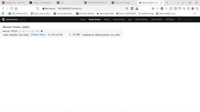

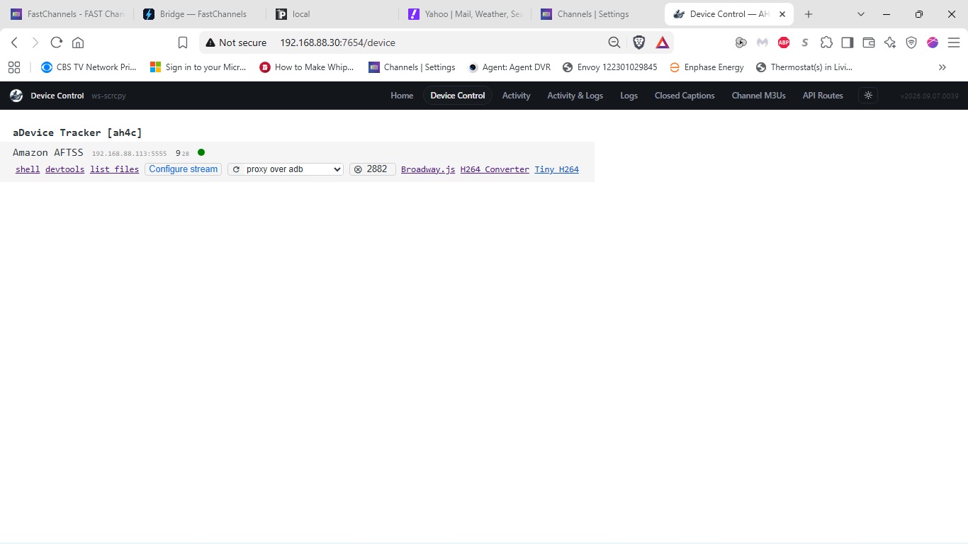

How about screenshots of your ah4c Activity and Device Control pages?
@daldana7296 I'm running out of ideas. I guess you could try stopping the ah4c stack, and then do a Re-pull and redeploy just to be sure you have the latest version. Then when ah4c is restarted try one tune, whether it succeeds or fails, and then post then entire log from boot to the end of stopbmitune.sh.

Could you post the CDVR logs for that same failed tuning block please? This will be it for tonight though. I'll set up a duplicate single-tuner test environment to yours tomorrow.
What does it mean to "bounce" a container? (I do command-line and GUI, but only minimally docker-literate.) Does that mean stop & restart or something more elaborate?
Agreed, enough for tonight. CDVR log below.
