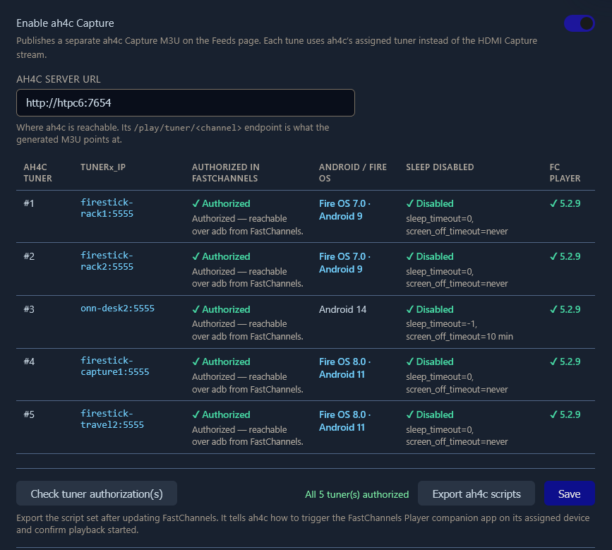

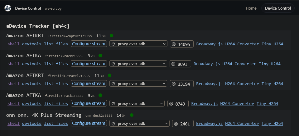

First, I would double check that both FastChannels and ah4c are showing they are adb authorized.
You can check FastChannels here:
And ah4c here:
Both need to show your device(s) as connected via adb. Green is good for both.

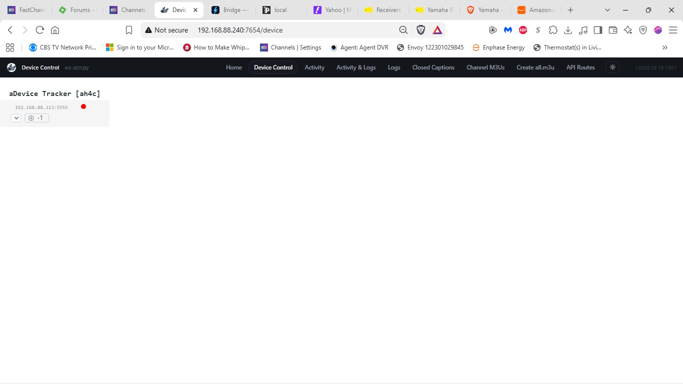

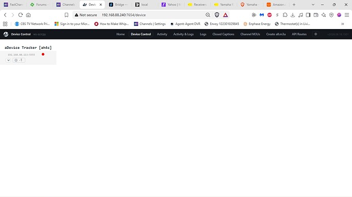

Also, it looks like ah4c is not authorized. I've got a recording going on via the FastChannels bridge, so I'll try to authorize it afterward.
