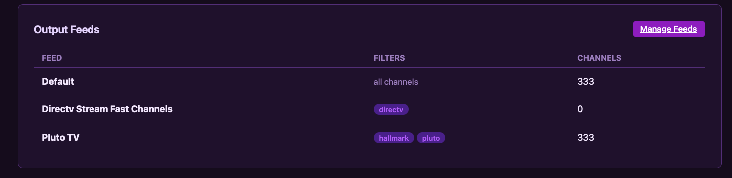

Yes, all good there.
All correct here too. All of your channels are showing as available via the bridge.

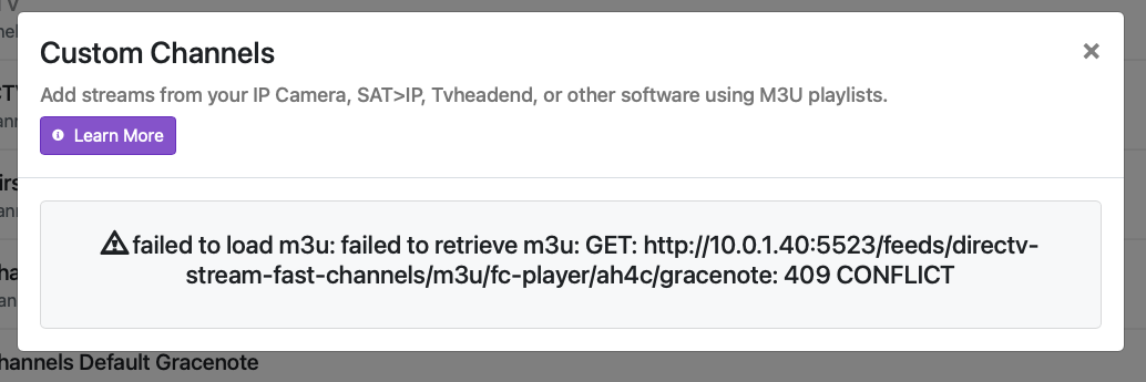

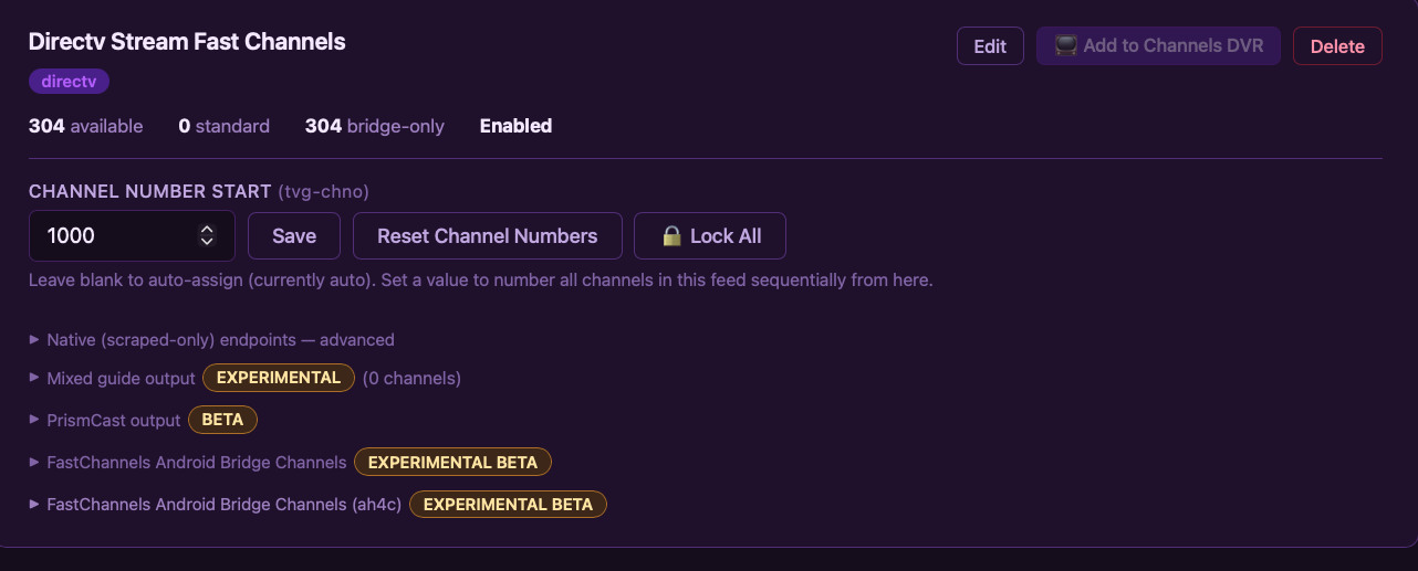

Just tried to edit channels source settings and got this:
I’m going to delete source in channels, delete the feed in FC, then recreate the feed.
My source URL looks a bit different:
http://htpc6:5523/feeds/fastchannels-directv/m3u/fc-player/ah4c/gracenote
Not sure what's up with that...
Nevermind, you just named yours differently.

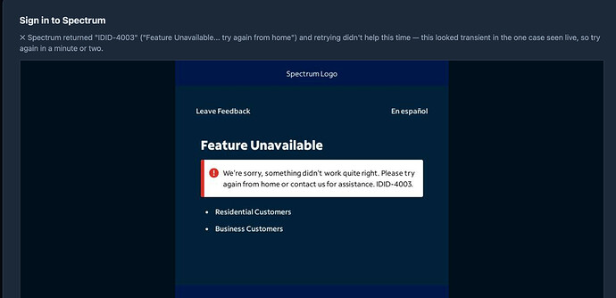

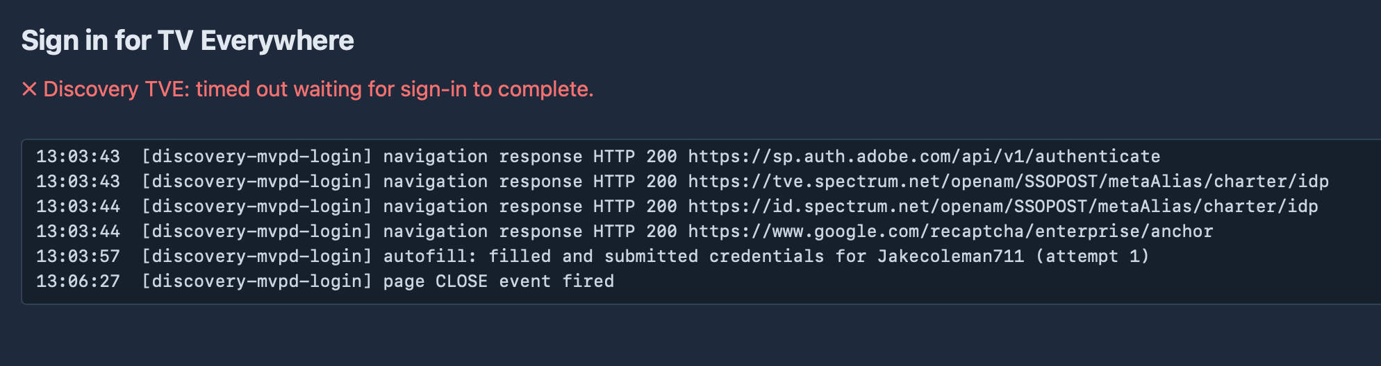

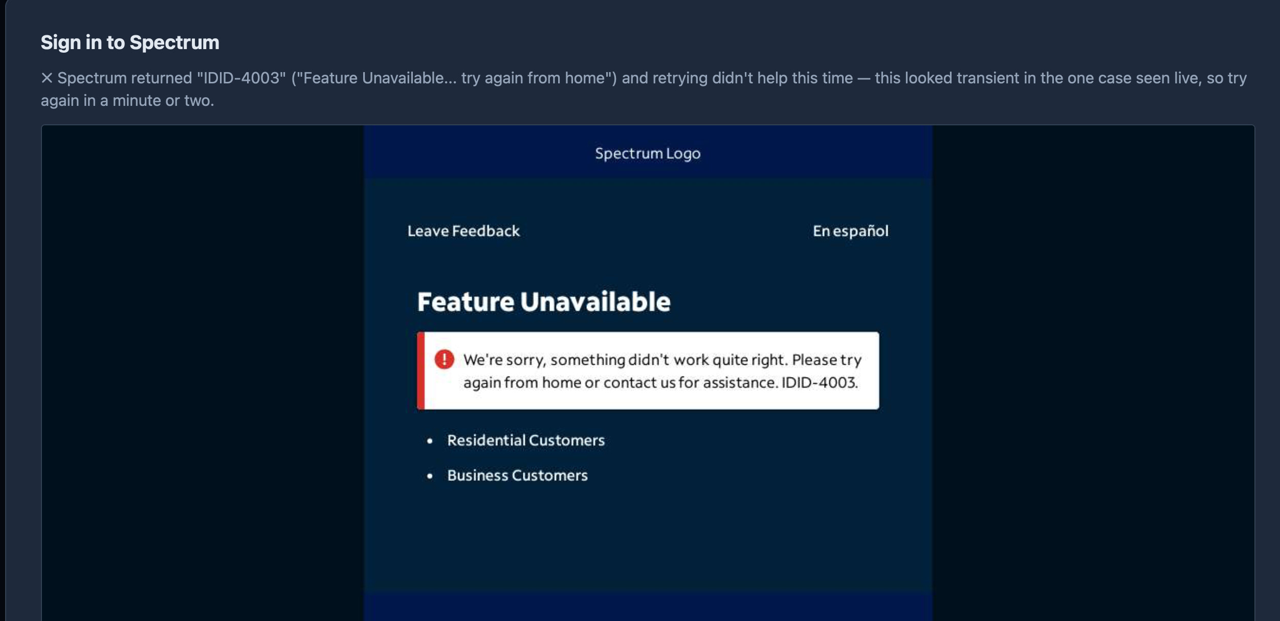

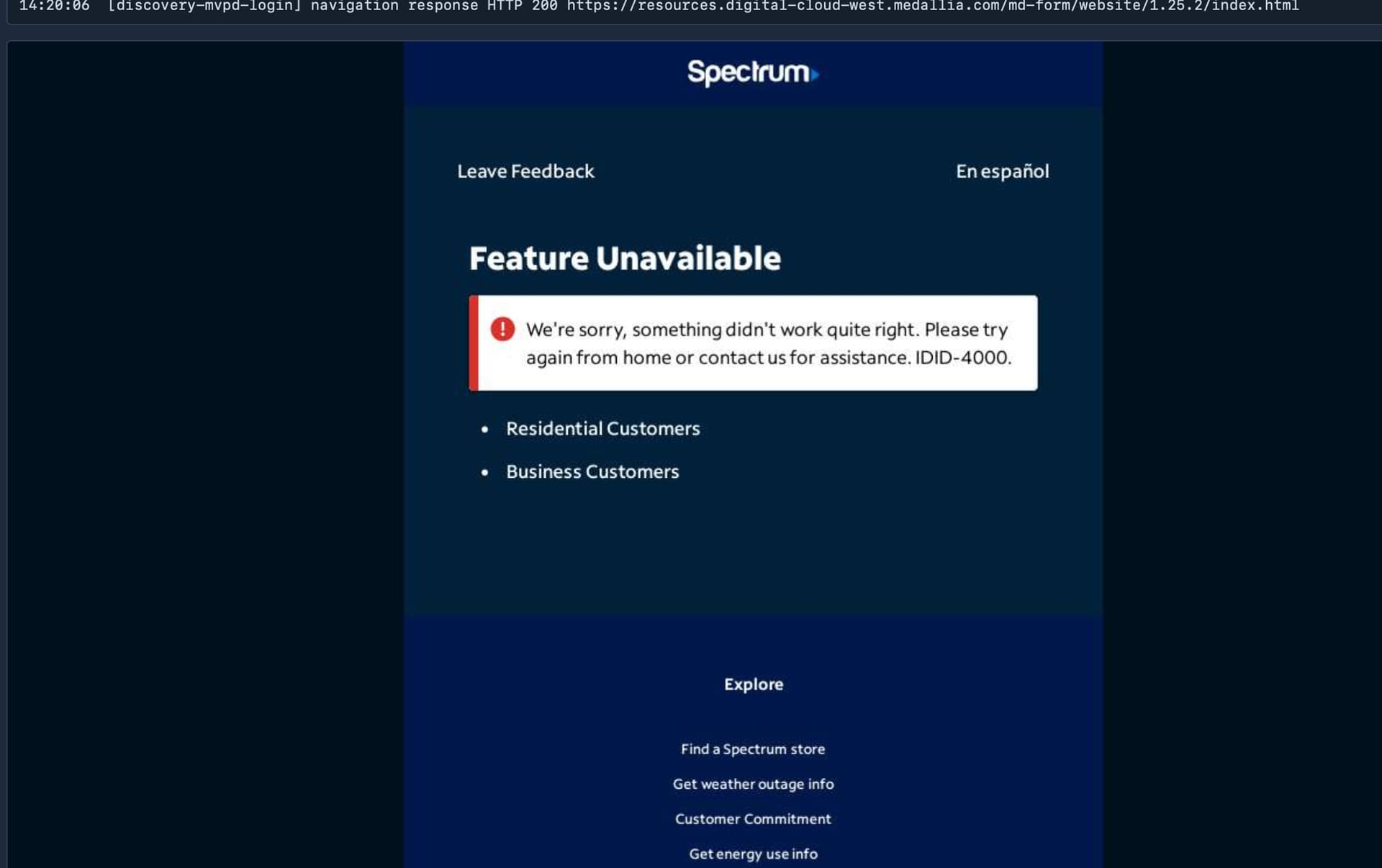

@KineticMan Tried version 5.3 yesterday with my spectrum login, as well as 5.3.2 just now.
Im still getting this after the retries....
Maybe we’ve been talking two separate things here.. are you trying to get TVE working, or the Spectrum scraper?

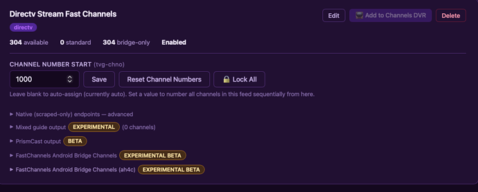

Making a little progress. I got the source back into channels. When I select a channel, it brings up the home screen from the stick. It’s like the Fast Channels player doesn’t initiate.

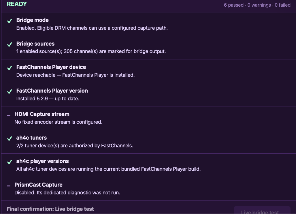

Here’s screenshot of post healthcheck:
The Live bridge test is grayed out.

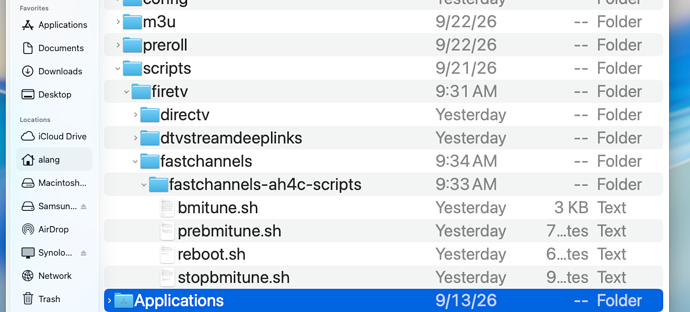

Logs from ah4c for the failed tune please.
The error sticks out
already connected to 10.0.1.62:5555
[EXECUTE] Stderr: '+ TUNERIP=10.0.1.62:5555
+ echo '[STARTING] prebmitune.sh 10.0.1.62:5555'
+ [[ 10.0.1.62:5555 =~ ^[0-9]+\.[0-9]+\.[0-9]+\.[0-9]+(:[0-9]+)?$ ]]
++ adb connect 10.0.1.62:5555
+ OUTPUT='already connected to 10.0.1.62:5555'
+ echo 'already connected to 10.0.1.62:5555'
+ [[ already connected to 10.0.1.62:5555 == *\u\n\a\b\l\e\ \t\o\ \c\o\n\n\e\c\t* ]]
+ [[ already connected to 10.0.1.62:5555 == *\f\a\i\l\e\d\ \t\o\ \c\o\n\n\e\c\t* ]]
+ exit 0
[EXECUTE] Finished running ./scripts/firetv/fastchannels/prebmitune.sh in 7.113125ms
[PREROLL] tuner= channel=directv:4730 stream ready in 10ms; 0 bytes of pre-roll played
[EXECUTE] Running [./scripts/firetv/fastchannels/bmitune.sh directv:4730 10.0.1.62:5555]
[EXECUTE] Stdout: '[STARTING] bmitune.sh directv:4730 10.0.1.62:5555
[ERROR] FASTCHANNELS_URL is not set to a valid http(s) URL (got '') β€” cannot trigger directv:4730. Set FASTCHANNELS_URL in ah4c's environment.

[CC] tuner0 video is H.264 on PID 100
[CC] tuner0 announced the caption service in the program table
[CC] tuner0 picture rate is 30.00 fps, cc_count 20, line 21 at 29.97 pairs a second
[CC] Warmed parakeet-unified-en-0.6b-Q4_K_M.gguf into memory in 136ms
[CC] engine: parakeet: using cpu backend (strict)
[CC] engine: parakeet: promoted 48 conv pointwise weights from F16 β†’ F32 for CPU backend
[CC] Loaded parakeet-unified-en-0.6b-Q4_K_M.gguf (1 in memory)
[CC] parakeet-unified-en-0.6b-Q4_K_M.gguf is running on CPU
[CC] tuner0 captions on: parakeet-unified, en, continuous, on the processor, ready in 4.506s
[CC] tuner0 audio decoder: [h264 @ 0xaaaafbfa7470] non-existing PPS 0 referenced
[IO] io.Copy: write tcp 172.20.0.2:7654->192.168.65.1:32647: write: broken pipe
[IOINFO] Successfully copied 572084 bytes
[IOINFO] Transfer speed: 0.24244590826303128 Mbits/second
Performing Close() for 10.0.1.62:5555
[EXECUTE] Running [./scripts/firetv/fastchannels/stopbmitune.sh 10.0.1.62:5555 directv:8249]
[EXECUTE] Stdout: '[STOPPING] stopbmitune.sh directv:8249 10.0.1.62:5555
+ STATION=directv:8249
+ echo '[STOPPING] stopbmitune.sh directv:8249 10.0.1.62:5555'
+ adb -s 10.0.1.62:5555 shell am start -n com.fastchannels.player/.PlaybackActivity --es command warm_stop --es channel_key directv:8249
+ exit 0
[EXECUTE] Finished running ./scripts/firetv/fastchannels/stopbmitune.sh in 68.791625ms
[GIN-debug] Request: 192.168.65.1 GET /play/tuner/directv:8249, latency: 18.946932342s, status: 200
[CC] tuner0 captions stopped
[CC] Freed parakeet-unified-en-0.6b-Q4_K_M.gguf (0 in memory)~~~
This is the TVE spectrum log in. I didnt see the "terms and conditions" pop up this time, but on the first pass I saw the autofill work, but got this:

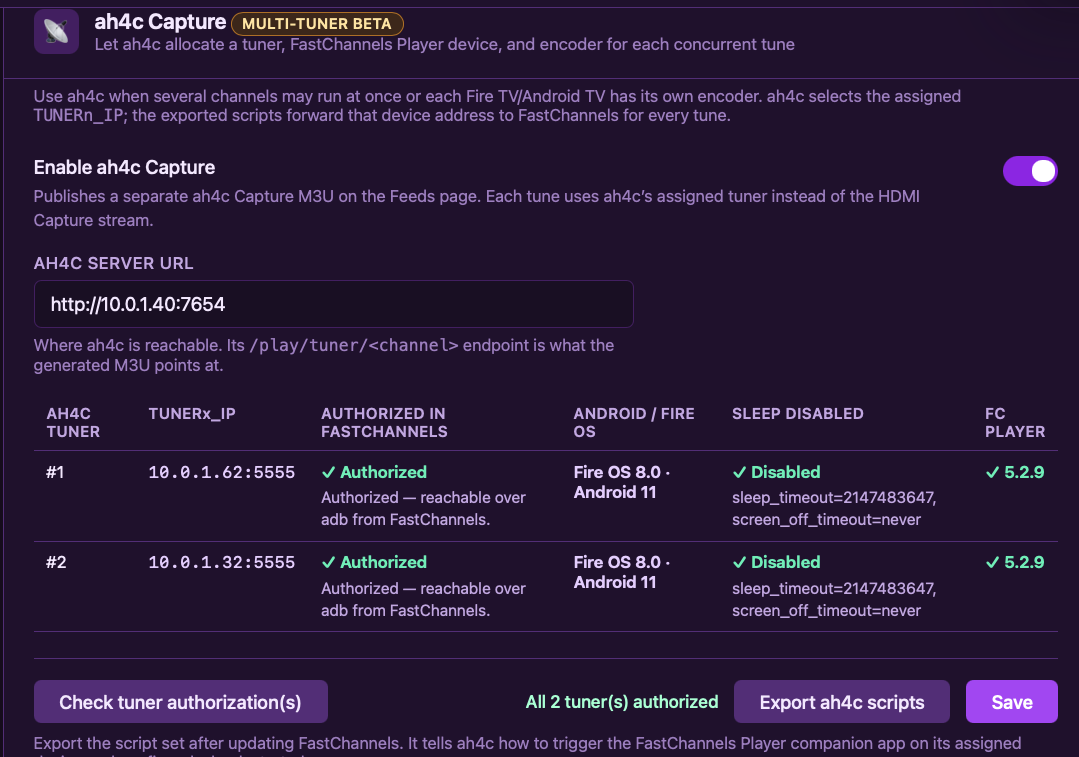

@bnhf
Such a noobie error. Both tuners working correctly. It’s @anon38303228 fault giving me a webui versus environmental variables. :laughing: :laughing: :laughing:
Fix the above, and double check your devices are ADB authorized in ah4c (this is in addition to them being ADB authorized in FastChannels):
oh. well, the whole time i thought you were trying to setup the Spectrum scraper (that works with the bridge). I haven't done much with Spectrum TVE, but i can look into it next.
pls test the Spectrum scraper sign on

I'm actually already on 5.2.9 happy to send over the full logs (ah4c, FastChannels, and the TiVo logcat) if that would help, just let me know where you'd like them.

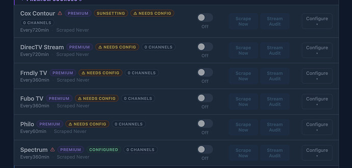

I tried signing in from here:
And got this just now.
Im migrating all my premium channels off spectrum and replacing with other packages, but keeping spectrum as TVE only with a base level package.
I may need the ah4c bridge , which I haven't configured that yet.
If I can bring in TVE spectrum through fastchannels, my next step is to get my paramount plus subscription channels into CDVR
Do you support paramount plus right in fastchannels?
First of all, thank you for all the work put into making Spectrum work with Fast Channels!
I am a Spectrum user, not coming from COX.
I sometimes get a black screen when tunning one of the Spectrum channels, and have to wait a couple minutes to be able to tune Spectrum channels again.
When I look at the FastChannels log I see the error below.
2026-09-24 17:11:04,613 WARNING app.routes.play: [license-proxy] spectrum channel=64054 upstream returned HTTP 401 (150 bytes): b'{"resultCode":"2076","resultCodeName":"INVALID_TOKEN","resultMessage":"Invalid Token","error":"invalid_request","error_description":"TOKEN_NOT_VALID"}'
Thank you.

great report-- found the bug and will fix in next version
so short of this bug, u were able to sign into spectrum??!?
Thank you!
Yes, I was able to sign in with no issues.
