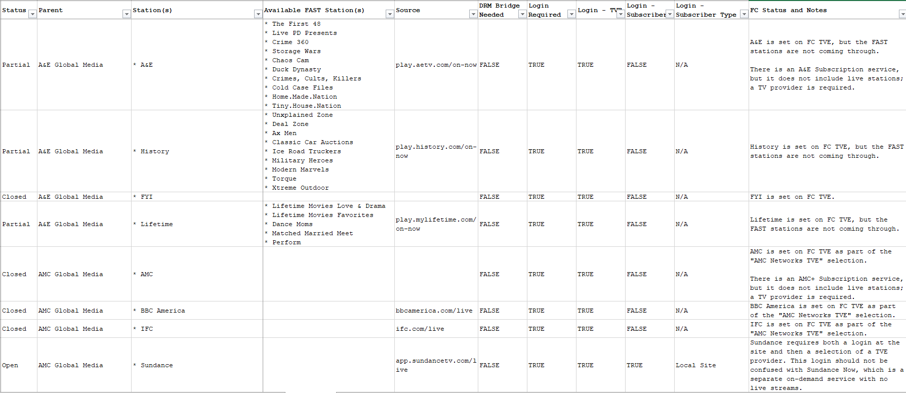

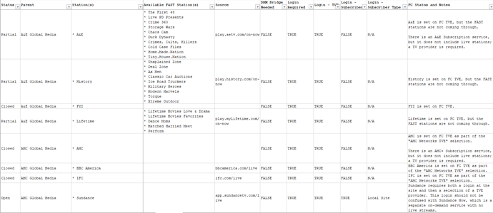

I started working on something before my vacation; I'll have it finished soon and post to the FastChannels repo to make it much easier to have a complete list of these things and update as needed...
