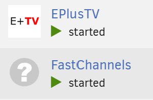

@KineticMan quick side question. Do you have an official (or unofficial) icon at a URL somewhere for this project? In the UnRaid Docker manager, you can add an icon for a project and I would like to make it look more pretty. :rofl: Below is an example:
For example, for E+TV, it gets the icon from the following URL:
https://i.imgur.com/LrdVje2.png
