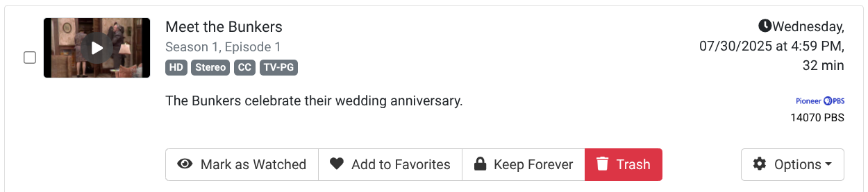

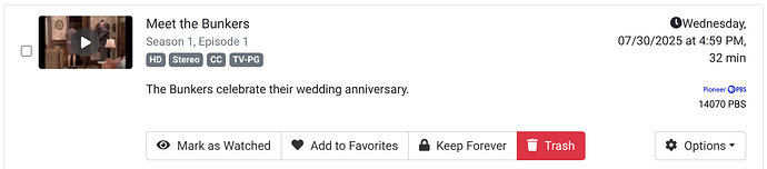

That would be great! One thing I don't like is that every time channels get re-numbered, CDVR doesn't just re-number for future programming, it also re-numbers everything you have previously recorded. That drives me nuts! Depending on how many changes one makes to their sources, what was originally recorded on a Classic TV series channel could end up looking like it was recorded from a PBS channel.
Example: I know for certain that this episode of All in the Family did not air on Pioneer PBS:
If the reassignment of numbers could be limited to everything from that point forward, and leave my old recording metadata alone, perhaps I could be happy.
