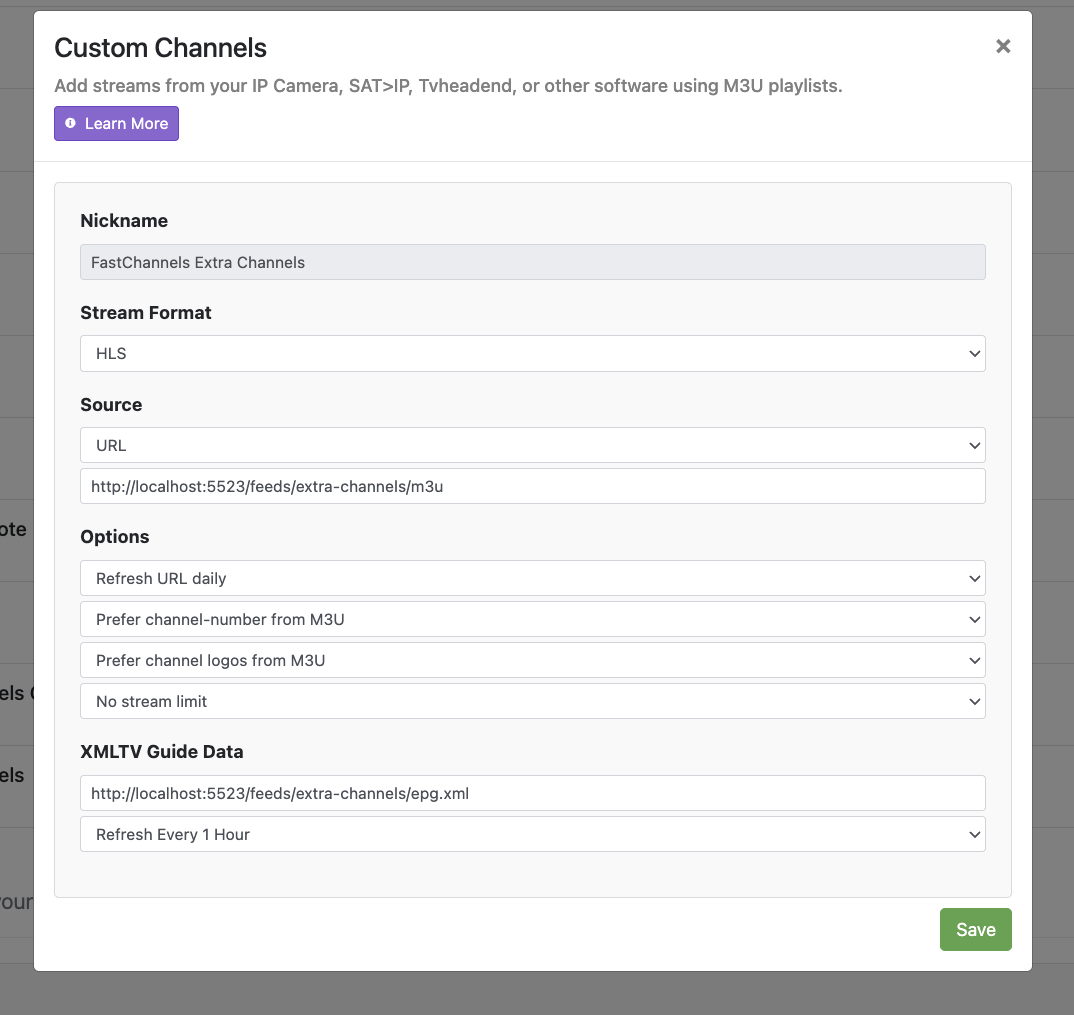

What does your Channels DVR source setting look like
I think it's set correctly

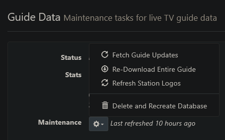

Do a Delete and Recreate Database in Channels DVR
Screenshot 2026-05-12 at 19-33-17 Channels Settings
I just changed to letting CHDVR assign and deleted and recreated database. Still no guide data. The only thing that seems to bring guide data back is when there is an update to fastchannels

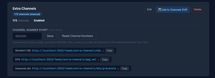

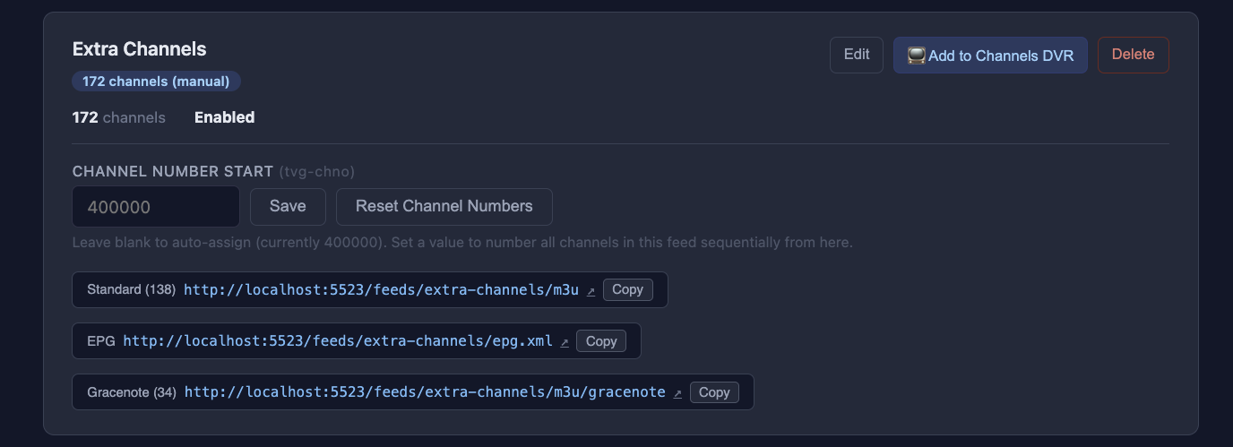

What does your extra-channels Output Feed look like in FastChannels
I would recommend using the hostname or IP address of the device running the container instead of localhost
I will try that again but it did not work previously.
The IP address should work.
I think that is the issue. the local ip is not working, only the localhost
