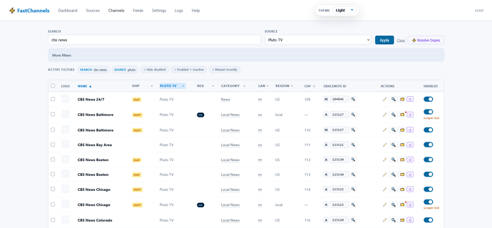

Hmmm... then I think I found a different issue (albeit minor and most likely not a real problem).

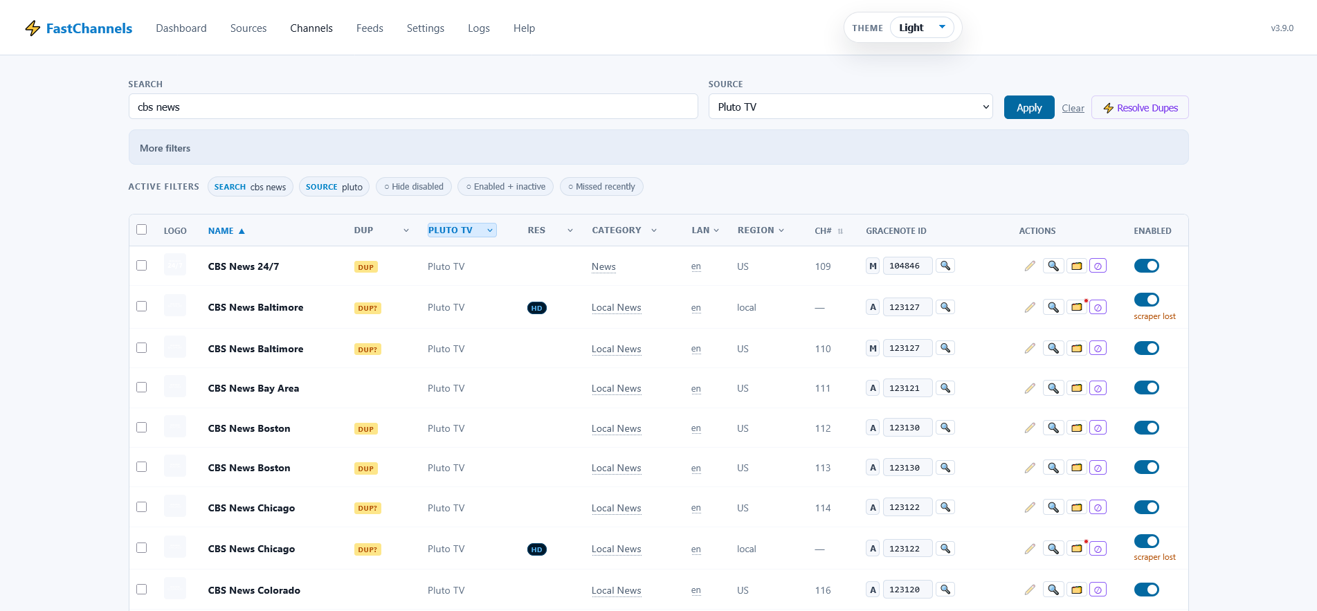

See in these CBS News locals in Pluto how there are two version, with one that is "local" region and "scraper lost", and one that is "US" region and fine. However, the "scraper lost" ones all work when I play them. I'm guessing that region "local" has been eliminated from the search, but a number of the stations are still sticking around.
Nevertheless, that's not the only situation along the same lines.

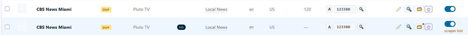

Here, there is no difference on the metadata that I can see, but one is "scraper lost" even though I can play it just fine, too. I'm not sure if these are just artifacts from various FastChannels releases or what, but there are other ones scattered around like this.
Of course, I know I could just disable and re-enable the source and clear them out, but thought I'd point out some stuff that is happening.
I think you're right-- that looks like some old channels prior to the regions addition that got orphaned. I def missed a migration step when I added that a long time ago.
Quick fix - run the Cleanup Inactive Channels program from admin/sources. I bet it'll find those and clean 'em up for you.

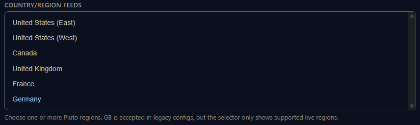

Does this mean I need to change the Region on my Pluto source?
It's still set to local, but that doesn't display when I edit the Source.
I mean it's working, so not sure I want to fix what isn't broken.
not gonna lie - I'm having a chDVRuser moment and honestly don't remember what I did with "local" as a Pluto region. I must have removed it for a reason.
I don't want to break your setup, but honestly might be best if you do move to one of those regions. You'll probably get some orphans.............. sorry
It's still scraping fine.
I'm pretty sure the only difference between east, west and local is the IP address sent to the pluto api, where local uses mine instead of a fixed IP override for east and west.
ahhhh ... question is - should I re-add "local" ?? curious if it gives different channel lists.
If you can't remember why you removed it, why not add it back (since that's what I'm using and it works).
See line 28 of app/scrapers/pluto.py
and line 53
probably can't hurt. I'll re-add next version.
