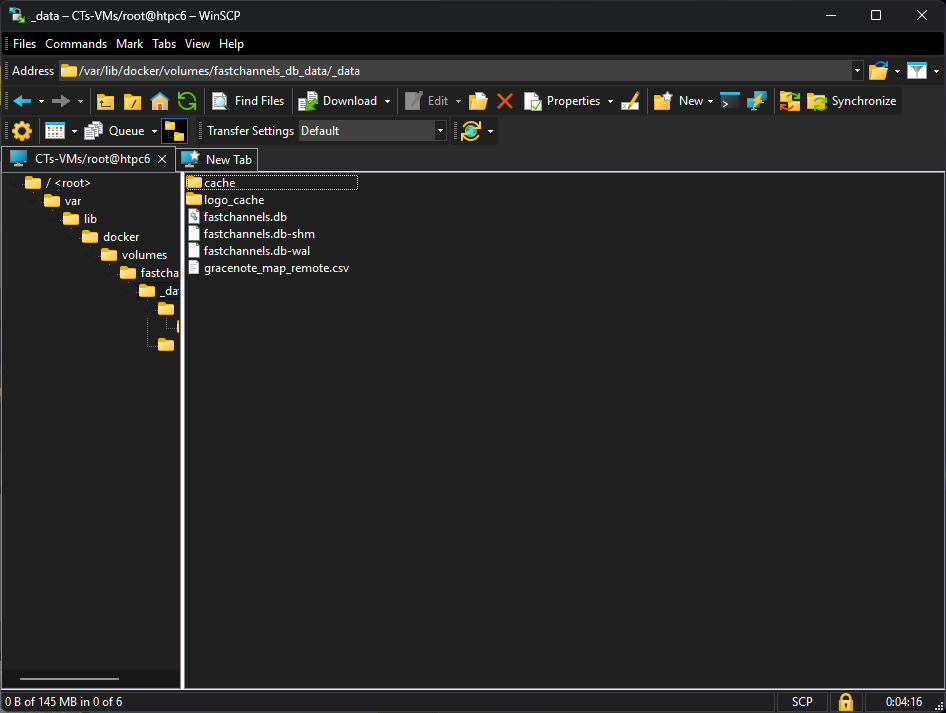

There's more than just fastchannels.db in my Docker/Portainer Volume:

i created the final containers through docker desktop (windows)/docker app (ugreen)
ill try replacing them all now just for funzies...
edit: ooff, this might take a bit, there is 19000 files in the data directory....
Those cache directories do have a lot of files, but I believe they're fairly small. The files, not including those cache subdirectories, are likely the most important.
yeah, the ugreen no likey small files...its poking along at 12KBps
and thats to an internal nvme over a 2.5gbe connection, not the rust spinners...
it must be doing something to process them as they get written.
i did drag and drop to the ugreen app rather than ssh, so perhaps there is a buffering issue somewhere. it went pretty fast when i added all my large media files to rust spinners.
i guess this is why. should have zipped it first and unzipped on the nas.
"If transferring thousands of tiny documents, photos, or code snippets, your file transfers will drop to a crawl. Every single file requires its own system overhead (checking permissions, locating disk space), overwhelming the system's input/output."
yup, that was stupid. over 2 hours and only 75%
just zipped it transferred it up, and decompressed in less than a minute....

edit: i hosed the copy. retrying.
ok, that worked. had to restart the container a couple times. it coulnd find the network on initial startup, but on a restart it found it.

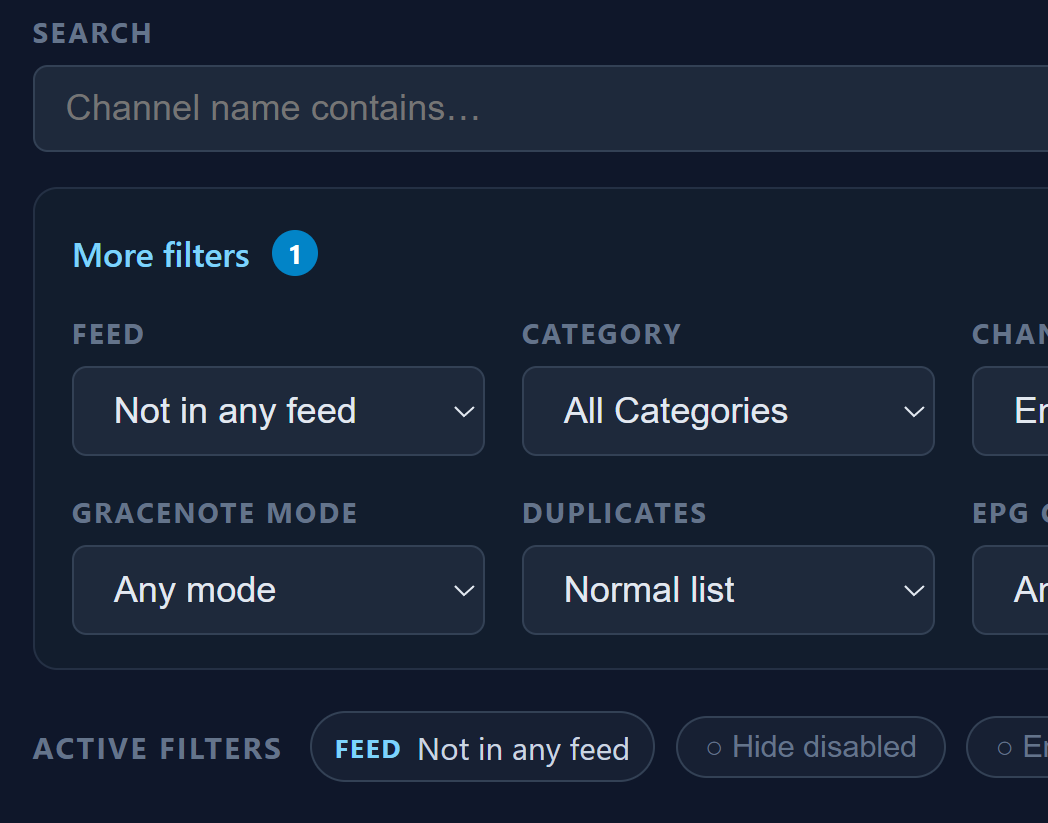

any way to add a dynamic list of enabled, but unassigned sources to the feed screen?
with so many sources, and more coming all the time, its hard to keep track of what i have and havent added to the feeds.
On the Channels tab, click the drop down for Feeds...
