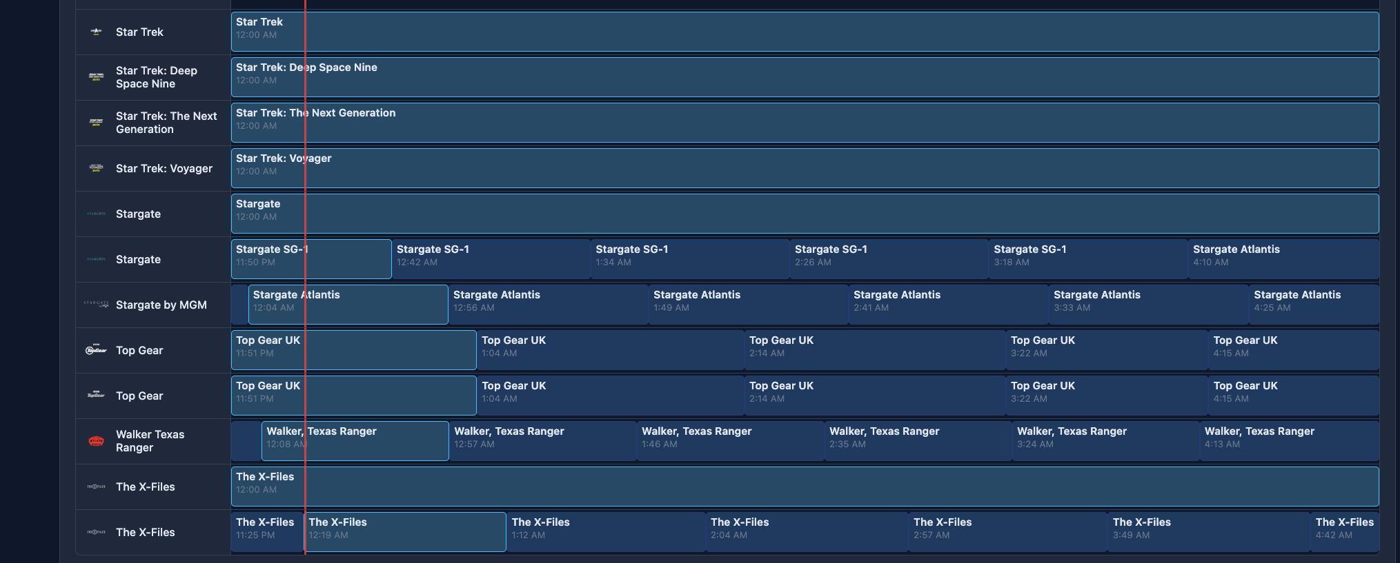

Has something changed with Guide data fro Pluto?
The other day, was just generic image and no actual data.
Did a force refresh and then things were fine.

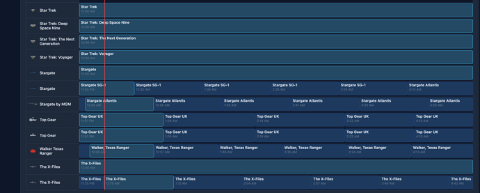

Seeing it again now.
ver. 4.5.0
Before refresh:

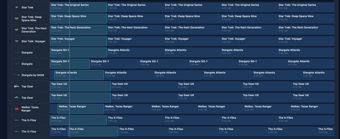

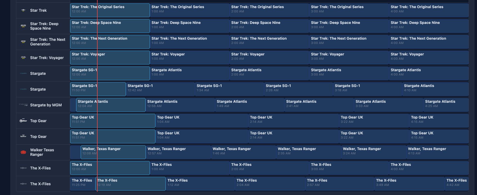

After refresh:
