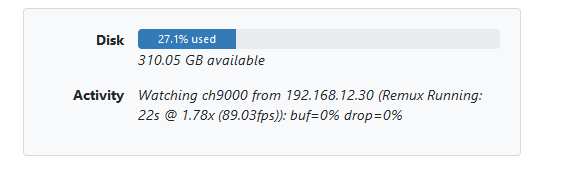

Works great. Issue is the source channels server is remuxing
I tried using http://192.168.12.40:8089/devices/ANY/stream.mpg but that errors out.
Anyone know the correct syntax to avoid remuxing with the ANY parameter?
http://192.168.12.40:8089/devices/ANY/channels.m3u?format=ts
I tried that but looks like it still want to remux

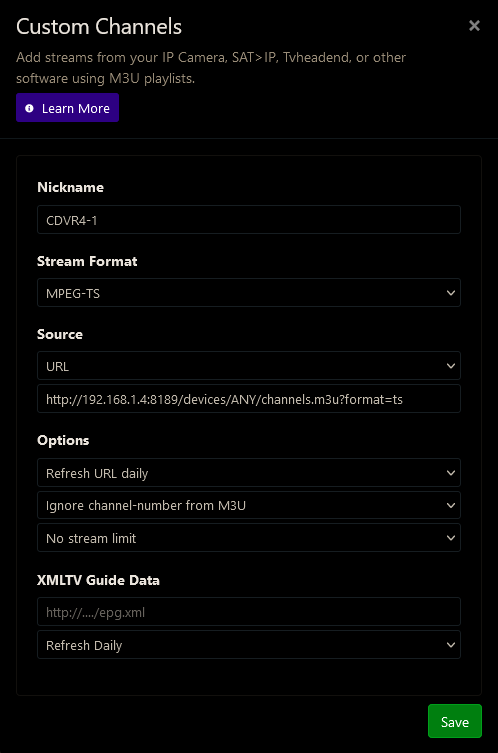

Works for me.
Try recreating the custom m3u source using a different name.
Should display Watching... NOT Remuxing.

Change format=hls to format=ts.
Would that matter if the source channel was hls?
I'm wondering if ch9000 on the feeding server is hls or mpeg-ts...
Is the screenshot slampman provided from the feeding server or from the main channels server?
Source is hls. I tried changing to ts and I got the source error on the client
You need to append the format=ts to the URL, and set the Custom Channel to MPEG-TS.
Internally, Channels uses TS. If you use format=hls (which is the same as using no query parameter at all), then Channels will serve using whatever you have set in the Web Player transcoding options.
Ahhh thanks. I was thinking that since the source on the source CDVR server was HLS I needed to also do HLS for the receiving CDVR server.
So basically: hls source -> Source CDVR server hls custom channel -> Source CDVR server mpeg-ts -> Receiving CDVR server mpeg-ts
Correct.
That wasn't what I posted, this is
and this
