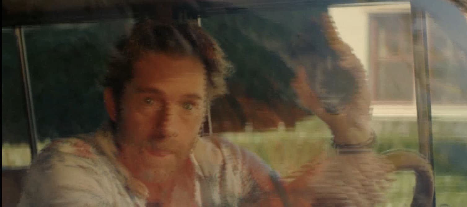

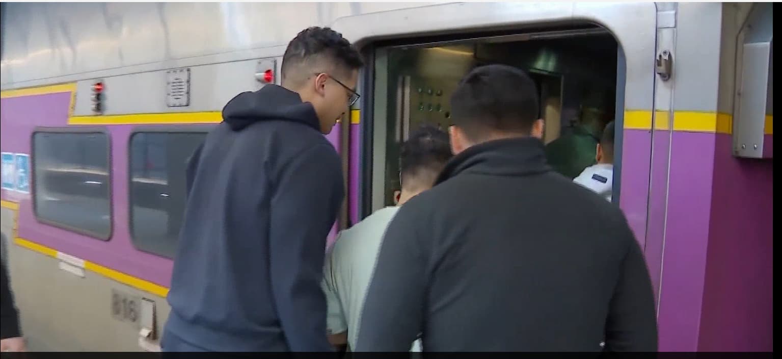

Thank you.. So the channel will play audio with FFmpeg transcoding, but the video is giving issues with FFmpeg transcode but not with FFmpeg transcode off? What artifacts are you seeing?
its deinterlacing artifacts.
on fast screen transitions, like news graphics, you can see the interlace lines...
ill see if its doing that with the ffmpeg recode off and let you know..
Thank you..
looks like its not doing it with the recode off...
Its basically anything moving quickly.
peoples hands, cars, etc.
Could be post processing artifacts from FFMpeg, but its definitely interlaced scan lines..
got a screen grab for you
Heres another ones that's no so noisy
